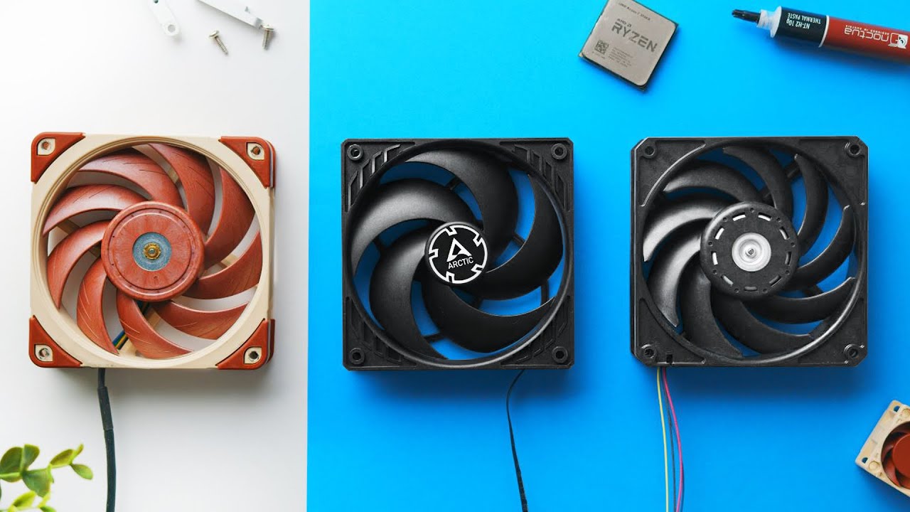

I’ve just seen the video of Jay about the difference in fans and noticed him stating that fluid bearing type fans are not that good when it comes to longevity:
Since I have built a new PC in December and also bought seven SilverStone SST-AB-120R I immediately googled the life expectancy of fluid bearing fans and stumbled over this article by GamersNexus:
Now, I’m a bit confused, because here they applaud the longevity of fluid bearing fans.
Do you know the reason for the difference in both opinions? Or has the market changed that drastically from 2012, when the GN article was written by Steve.
