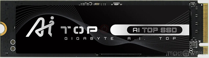

Fake news 60 DWPD m.2? Gigabyte
Over 20 times the endurance of best in class datacenter SSDs, basic rendering with very little info, m.2 form factor.
How likely is this product to ever ship?
There’s a lot of ways to do this that make sense. Operating the NAND in MLC or SLC mode would be the most obvious and expensive route and should be able to easily hit those numbers, but they could also be playing creative games with the warranty period and rated operating conditions, and expecting higher replacement rates, counting on that AI MoneyNOW! to enable them to claw a market advantage elsewhere to weather the oncoming storm.
Perhaps there is also a caveat that there is no guaranteed data retention after turning the power off. As a “memory extension cache drive” only.
Could be, IIRC Optane is rated for not very long on data retention actually, which might be part of it’s high endurance rating. However, with stacked NAND, the data retention characteristics started taking a different, less linear shape, so I think this probably isn’t it.
I can’t find the papers through all the AI sludge anymore though, but unless I’m crazy, the curve favors data retention in 3D nand relatively early in it’s write life, and drops off faster after the rated PE cycle count.
That doesn’t look like the case, judging by its TBW rating of 219,000TBW.
Samsung 990 Pro 2TB has a rating of 1200TBW for reference.
But if your warranty is a year, it doesn’t matter what your TBW is, because the product is out of warranty before it ever reaches that… :croissant:
Plus, you can claim it failed because oh the temperature was too high, or too low, or varied too much, or varied too little, or the space dust wasn’t aligned just right or whatever. NAND data retention and write endurance are tied heavily to temps and voltages.

Must be PMLC/PSLC then. PSLC would definitely get you there.
Or they’re just lying about it.
I think it’s a 8tb qlc ssd in SLC mode (2TB) or 4TB QLC (1TB), similar to that solidigim D7-P5810 which performs kinda close to optane, latency and DWPD wise

Sadly, I just saw this post. I could have cleared this up. It’s a Phison E18 with updated LDPC technology, running in SLC mode, with the extra space rolled into overprovisioning. So an 8TB (8,192) drive in SLC is 2,730GB. The extra 730GB is OP. Pair the SLC, OP, and the modern LDPC gets you there.
Pricing has yet to be disclosed, but given the specifications, it should be cheaper than the AI TOP 100E 1TB, which retails over $2,600 at some retailers.
