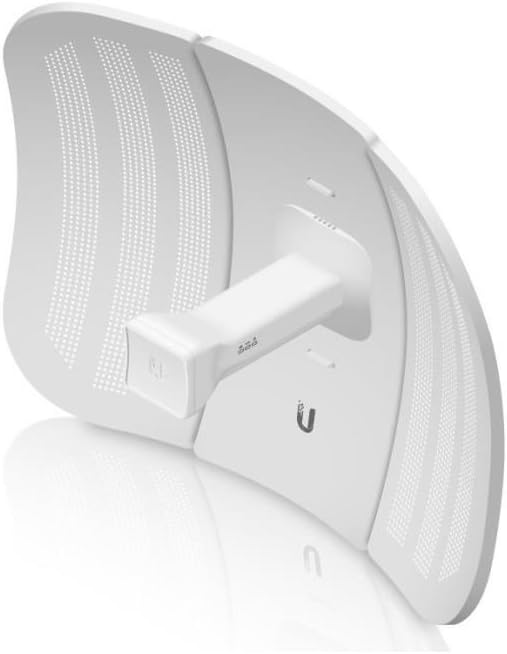

You could try a Ubiquiti PowerBeam kit. They range in price so it would be up to you on how much you're willing to spend and how much trouble you're willing to go through to set it up.
Had the same idea, but it is a bit pricey. Units start at ~$50:
And you would need two of those, plus an access point which is another ~$80.
