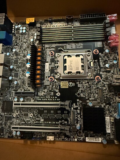

I settled on the Supermicro H13SAE-MF with an LSI 9300-16i with 96 GB of Kingston ECC memory by way of 2x 48GB. Plugged in all 18 total drives (whew) and got to migrating. Tossed out a few of them so my pool is 4x 12TB and 4x 8TB.

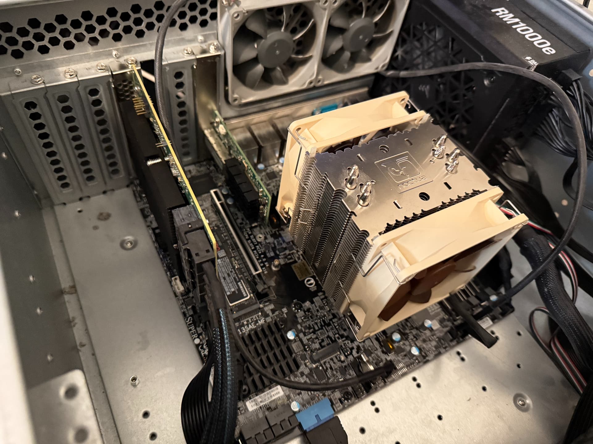

The reason I chose this board over others is because of the full length 16x pci-e slots and the 4x slot. 4x slot has the 10Gb Connectx 3 card, while the bottom 16x slot has the HBA. The reason for the separation is really just for heat reasons.

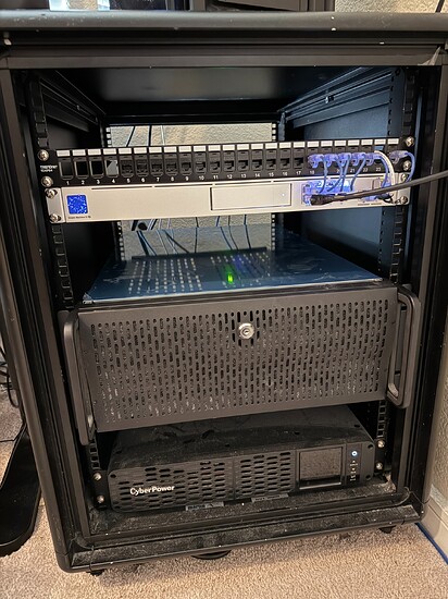

The case is a Rosewill RSV-L4500U

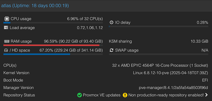

Running Proxmox, these are the VM’s its hosting:
  • Wireguard
  • Plex
  • Rclone (for offsite backup)
  • Backend python API for CompareBench
  • Separate DB vm for that project
  • Sentry instance for bug tracking
  • Windows VM for testing
Before anyone asks, because it seems a lot of people I’ve shared this with don’t quite understand lol: The devices in their specific slots are intentional. The HBA is only 8x so regardless of if theres something in the top 16x slot, it will only ever run at 8x anyway so theres no need for it in the top slot. The LSI 9300 generates a lot of heat, so I want it in the lower slot to not negatively affect the SSD that’s in there.
