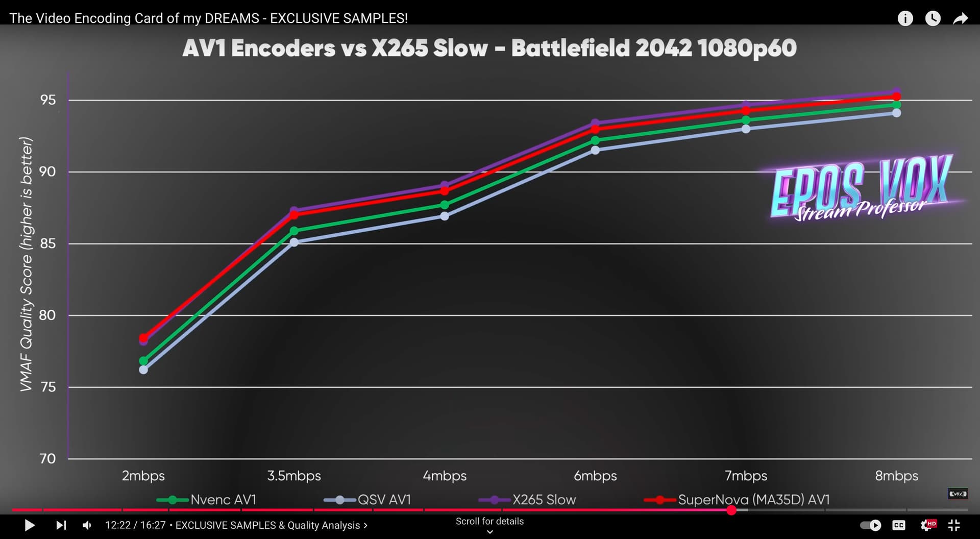

How close to the Alveo is it? if it’s very close that’s actually impressive.
… Dude

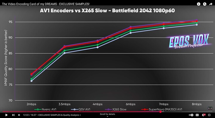

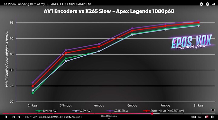

I think these are the relevant moments from the video
fwiw I dont really know the significance of these metrics myself, especially since the video files in question were video game live stream clips so it may not be as comparable to something like your saved movie and TV show episodes
Anything from the 9070 to compare? I know the Alveo is REALLY good.
that video came out a year+ ago so it predates the new Radeon 9070 by quite some time, and I have not seen many other resources or videos on the AMD MA35D to use as comparison.
However there appear to be some MA35D instances available on Azure https://techcommunity.microsoft.com/blog/azurehighperformancecomputingblog/introducing-the-azure-nmads-ma35d-exclusive-media-processing-powerhouse-in-the-c/4262008 so I did have a plan to eventually attempt some benchmark tests on there which might hopefully be usable to compare with the more recent AMD GPU’s such as 9070
Yeah, a more broader range of test footage with indexable graphs and data in a blog post would be extremely useful. I look forward to your data. I personally am just looking for VMAF graphs for the 9070 at the moment cause my current plan is to use the RDNA 3.5 of the 8700G.

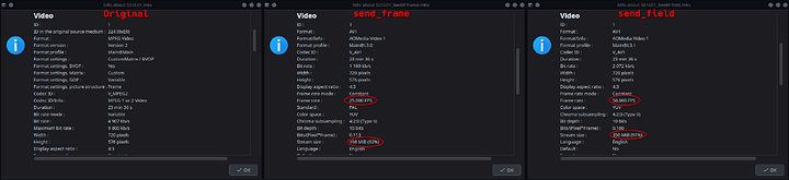

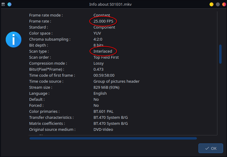

As a practical example, I ripped a couple episodes of an animated series from a PAL-DVD. So the original file is 576i50, i.e. 25 frames per second, and therefore 50 fields per second:

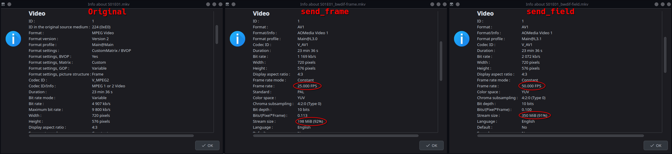

I ran this through bwdif once with send_field and once with send_frame, and the result is as expected:
So as expected send_field has double the frame rate because it’s delivering each deinterlaced frame twice, i.e. once per field.
This results in a significant (well… as significant as SD resolution can be) increase in filesize, but watching the video I don’t really notice a difference.
In fact when going frame-by-frame the send_field variant seems to look worse, but it’s not noticeable during normal playback.
So what exactly is the point of this? Going back to random reddit chatter, why are they convinced to ā€œnever use send_frame?ā€ What are the downsides? I don’t really get it.
Also crossposted to the Video Stackexchange, but no luck so far :confused:
Animated content is poor source material to expose the benefit of saving an entire frame per field because the content is inherently progressive. Similar issue with film but telecine complicates the issue. Using send_field can retain more temporal resolution but that temporal resolution generally doesn’t exist unless the content was recorded by an interlaced video camera.
Ideally using send_frame reconstructs a series of progressive images from pairs of fields. Fields from two different images can accidentally get re-combined which is why deinterlacing filters sometimes have an even/odd setting.
In contrast to interlaced content created from progressive source material some interlaced content is captured the same way it’s presented. First one field then the next. Deinterlacing content that was recorded interlaced using a complete frame per field retains the temporal resolution of an interlaced recording at the expense of doubling the spatial resolution.
Hm ok that’s kind of what I figured.
But that also means that realistically using send_frame is the right choice in most cases (for commercial media), since the original filming will have been progressive.
I mean especially in the NTSC/PAL/(RIP SECAM) era pretty much evrything commercially available will have been filmed on film and not digitally, so unless the digitization was interlaced for some reason, the source material would have been progressive, no?
Which would also invalidate randomredditor123 and it seems in most cases send_frame is the logical choice.
I guess the default in ffmpeg makes sense though because they can’t know what the source material was.
It really depends on the source material. For content that was created from a progressive source that was interlaced by creating two fields per frame (which does cover a lot) deinterlacing using send_frame is ideal.
Unfortunately a lot of filmed content doesn’t just use two fields per frame because interlacing and frame rate conversion are often part of the same process. To reconstruct filmed content properly rather than deinterlacing the process needed may be more accurately referred to as detelecine.
Yeah, that’s exactly the problem. Not knowing how interlaced content was created makes undoing it challenging. Even when it’s not ideal creating a frame for every field often tends to work better.
It’s all a bit of a mess…
