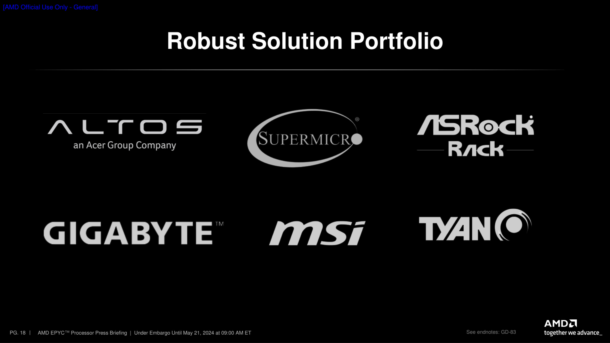

It’s looking like the following manufactures are going to provide AM5 motherboards with properly validated ECC support that can be trusted:
Interestingly ASUS and Asrock are absent from the list.
historically (AM4), MSI hasn’t really put in the necessary hardware ECC support on their consumer boards.
Might only be a thing for the new AM5 Epyc boards.
That’s exactly what I was thinking, but I just found out that MSI has a server division that isn’t differentiated from their consumer division very well.
