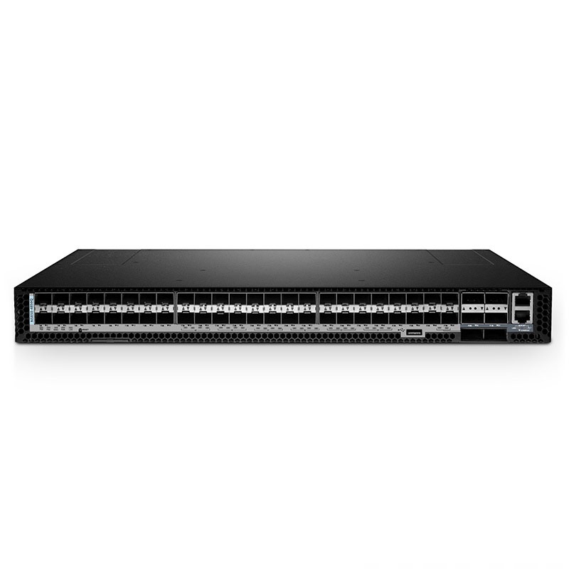

Ouch… way too pricey. Really looking for a switch with a few 25GbE ports and a 40GbE to connect to the serfer.
A switch with 25G links to clients/servers would not make sense to have “slow” 40G uplinks. Most would have 100G uplinks, like MikroTik CCR2216 @oO.o mentioned or the FS N8569-48BC or Aruba JL702A (← warning, shitty website)
Edit: Juniper EX4650 could be something. No idea about prices (and potentially required licenses though)
