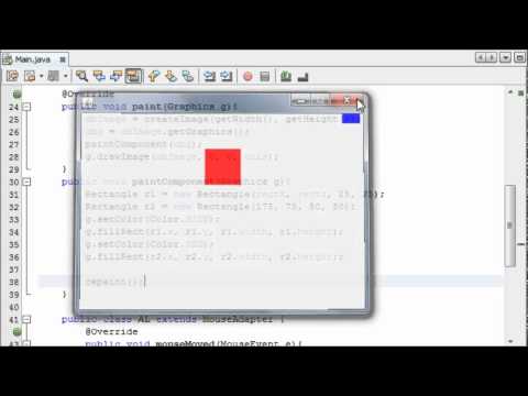

Hello again, so i watched a video about collisions and one of my classmates told me about do the images with Rectangle instead of JLabels, i found this video:
It really helped me out doing what i wanted too :) The only problem is the mouse movement, i saw that the squere that has rectX and rectY (the blue one) is on coordinates (0,0), i tried to change that on this line :
g.drawImage(dbImage, 0, 0, this);
From the paint method but it makes the squere to be a little far from the cursor, even if i change the values of the mouseDragged doesn' t work, any idea of how i could change that to work that way?
