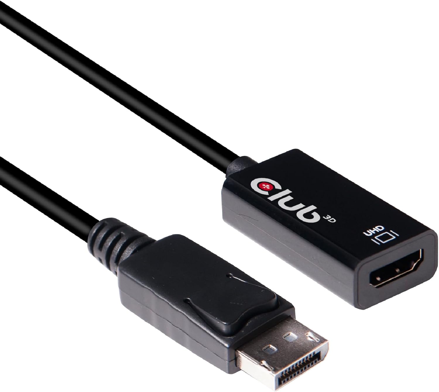

@GigaBusterEXE @Level1_Amber I tried using the CAC-1080 and this indeed solves my DSC issue :slightly_smiling_face:
Unfortunately there seem to be an issue with this adapter and/or my setup. After each reboot/hibernate at least one (mainly both) of the HDMI monitors is not recognized correctly anymore. Device manager lists it as nvfailsave, the resolution is set to 640x480 and all custom monitor configuration (monitor placement, scaling, etc) is lost. This can be fixed by re-plugging the screens (or switching to a different source using the L1KVM and back to the previous one).
Any ideas besides trying a different adapter (Amazon is going to kill me for all the display related stuff I returned lately :sweat_smile:)?
Have you tried updating your graphics driver? There’s a whole article about this happening on certain driver versions on the nvidia forum. As far as I can tell, this is a driver issue and not an adapter issue.
@Level1_Amber I’m running a pretty recent “Game Ready” driver 537.13. Latest one is 537.42 which I’ll try now.
In my case I think it’s not the driver, but the DP->HDMI adapter unfortunately. I’ll as well ordered another pair of DP->HDMI adapters for testing purposes.
