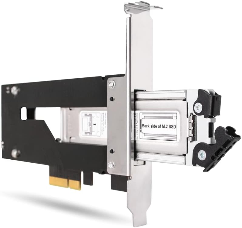

Yes, you can… But I would go with something like this instead:
With this it will work like any hot-swappable drive. Only problem is that you will give up a PCIe port, but that’s usually not a problem in a 4U file server.
I thought m.2 drives are not hotswappable.
I looked into this specific icy dock a bit, the detachable connection seems to be the drive m.2 socket itself. So either it’s doing some black magic or physically I don’t think it’s capable of hot swapping.
Yeah, you are right. I was confusing it with E1.S bays. Those have m.2 adapters that can be hotswapped. Something like this perhaps?
