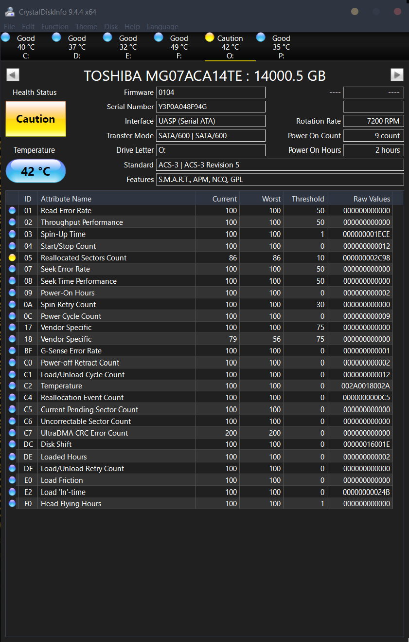

DoA Toshiba MG07ACA14TE, Has anyone else experianced issues with this model so far?
Just bougnt two new toshiba 14tb drives one for use and one for back up, and the one i put into an ecternal anclosure has connection issues and hang ups when transferring files. Upon checking drive health DiskInfo shows Reallocated Sectors Count currently at 11416, and it has been rising to this number everytime i try to transfer files to the drive. The first time i checked the normalized value vas at 96 now it is at 86. I am planning to refund the drive and get another one, but wanted to ask if anyone had issues with the model specified or had seen a similar case ?

The working drive tested fine for both a sector check and the smart test,
However i still could not get the broken one to run a smart test. It kept saying test failed due to unspecified error, and when i tried doing a write test it could not write to the drive at all giving an error “writing error; SPTI Command sending error; Win32 Error. Code: 5. Access is denied”
The program kept giving this error regardless of the security or ownership settings, and the drive would lock up in a writing state when i tried transfering files to it, but the file transfer would remain showing 0b/s, while the dirve itself would dissappear from the computer, not appeariing in the device manager or disk manager. Weirdly enough the external enclosure would still appear in the device manager.
After i tried everything i could think of i decided to just go for the refund before i ran out of time.

Yeah, that drive is beyond saving. It’s not so weird that the enclosure still shows up. The enclosure is just a usb->sata controller. Card readers also generally show up even if there is no card inserted.
Yeah, that’s the only option. I would advise to use another retailer for HDDs in the future.
