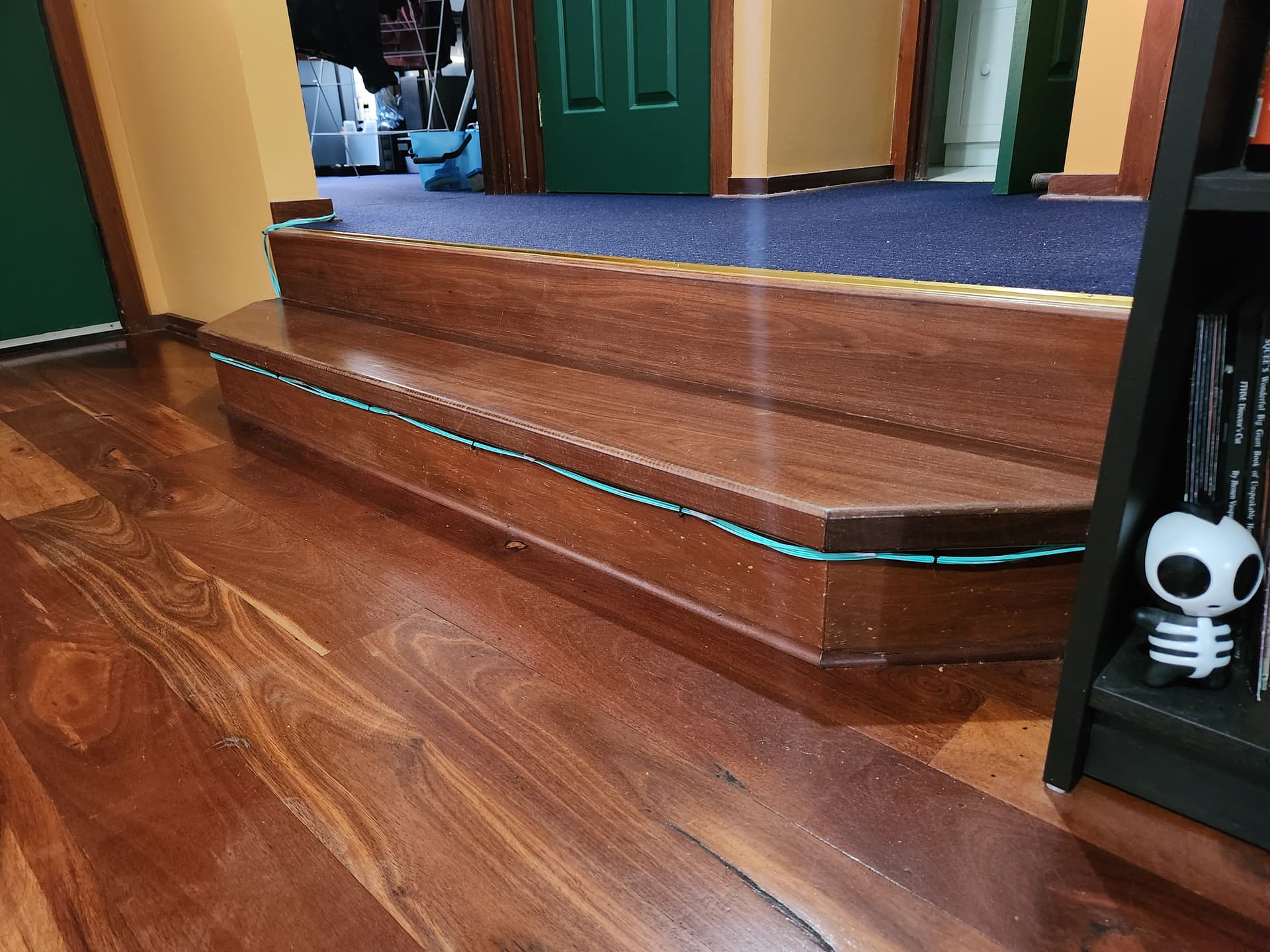

At the moment I have flat cat6 running down stairs and through hallways and doors.
It’s a fairly hostile environment for those tiny wires. They will inevitably get damaged, even with those floor cable protectors (eg: by closing doors).

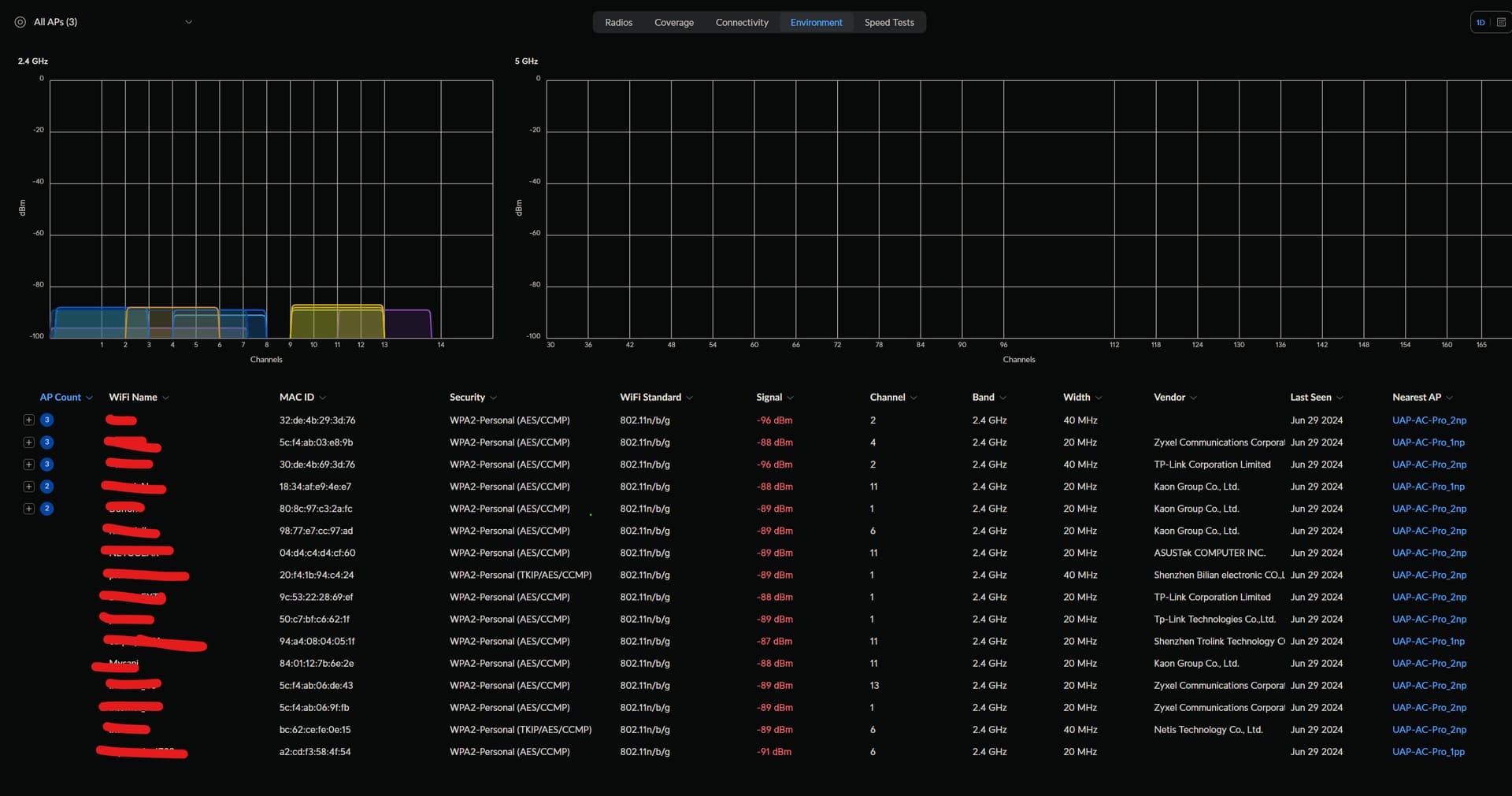

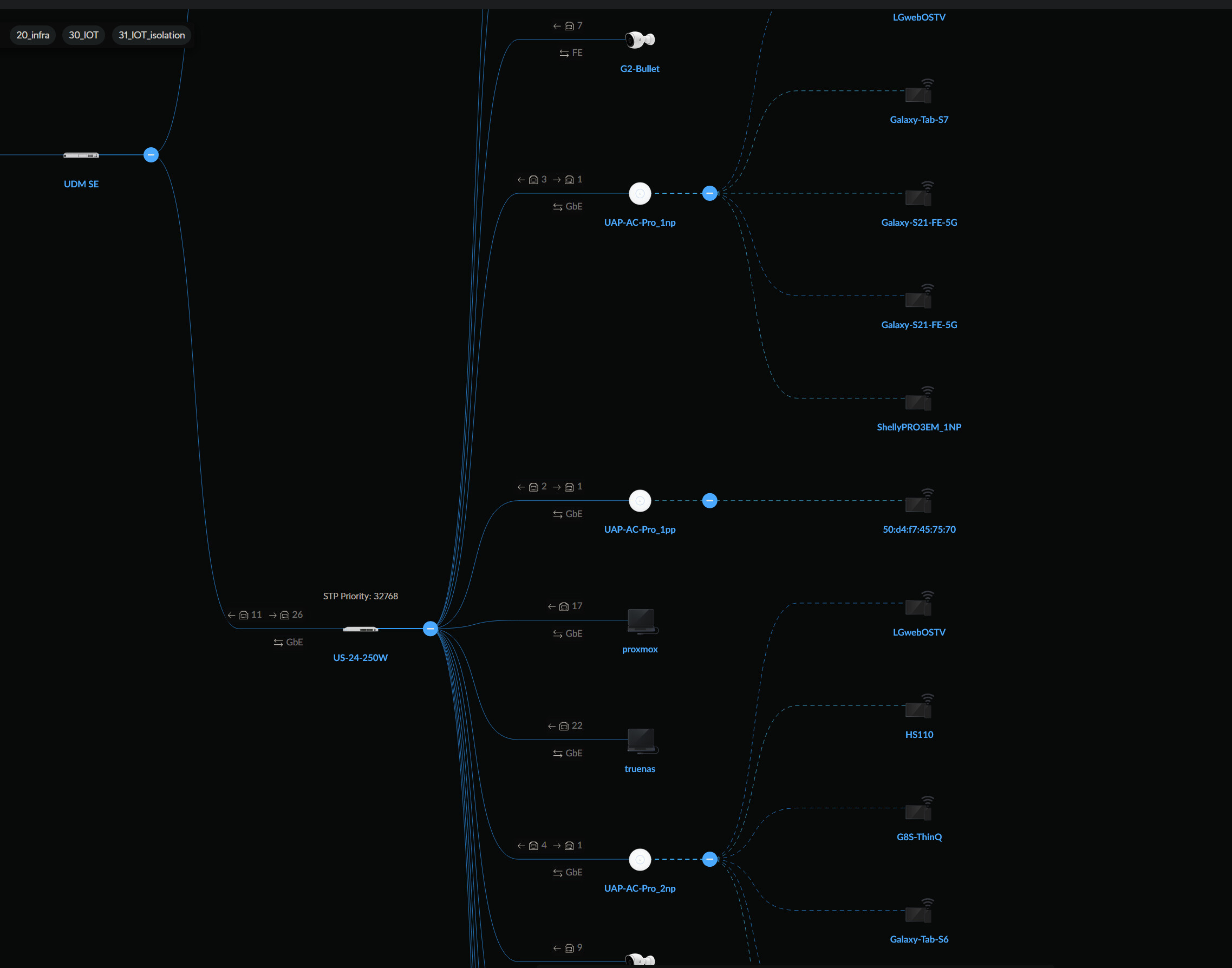

Edit: Pretty bog standard deployment of three floors, three wAPs and poe switch + router
and this is network environment I exist in, not much interference from other networks and complete freedom in 5Ghz range

I just thought of a stupid idea that I used for my rented apartement (but for hdmi to tv)
It’s on a sticky tape. Can easily pull off without damage to the floor.
Yup, that, or just taping cable to the corners or under the carpet. Doors are more problematic.

Oh no, I tried that. You(or especially someone, who doesn’t know there’s a cable) will step on it, and in time the cable will break. Had that experience (although it continued to work, but meh).
Also for the corners. I know it should be fine, but I’m afraid of those angles sometimes.
Tape and armored cable then, they can be sturdy as fuck. You just have to terminate them yourself.

If you need gigabit speed then a cable is really the best way to go. I’ve been running cables under doors and across the floor for years and have never had one break or even show signs of wear. So as long as you’re smart about how and where you run them I don’t think you have anything to worry about. As I said before I like fiber for this as it’s so much easier to work with, currently I have a bundle of fiber cables blu-taced under the lip of a step to cut across an opening
But in my last place I used one of those rubber cable conduit things and just put a rug over it, me stomping on it for 12 years didn’t seem to bother it at all.
