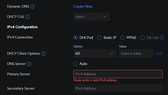

DNS Strict Forwarding just means the gateway will only allow the manually entered DNS servers to be used, and not overwrite with any DNS servers received by the WAN DHCP info right? Doesnt simply turning off “auto” on the DNS Server for configuring the WAN settings allow you to do the same thing?

Nope! DNS Strict Forwarding is that if you configure DNS A, DNS B, and DNS C your device will only communicate with DNS A, until it becomes unavailable, then DNS B, and then DNS C. Very useful for me because when I am doing server maintenance and Pihole goes offline, I don’t want the internet to go out and ruining my SO’s weekend.
