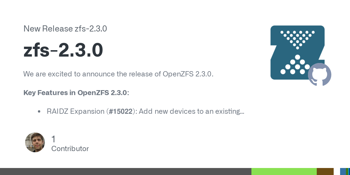

ZFS supports resizing as of 2.3.0

Anyway, it’s good to see OpenZFS is finally completing the minimum standard tool chain by adding resizing. Now add the same functionality to ZFS proper (as in: on BSD systems :wink: ) (yes I know it’ll trickle down upstream eventually, but IMO it’s still an oversight on part of the dev’s to implement it this late in the dev cycle :face_with_raised_eyebrow: )

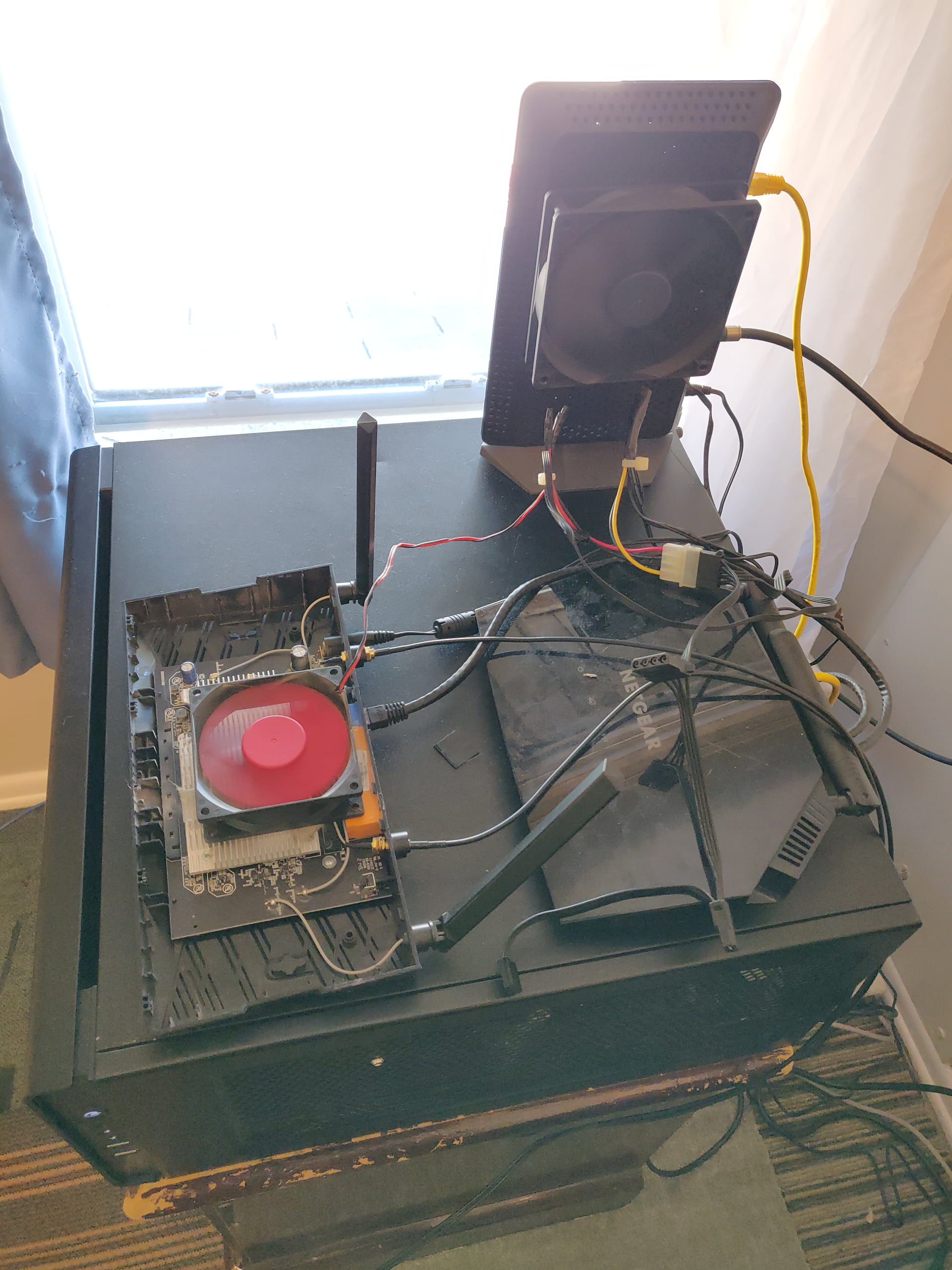

I used to use an old Phenom II X4 desktop with 2 HDDs (one main, one videos for Kodi set-top boxes). I have an Ivy Bridge laptop now as my NAS with the HDDs in dual-HDD bay USB-C enclosure. Disks and data for a small lab or home is pretty easy with a spare computer, and I got that laptop for free :stuck_out_tongue:
I had a Seagate Personal Cloud NAS years ago that did RAID1; one drive failed, I wasn’t able to view data from either drive plugging it in as-is to a Linux box, and the NAS OS was stored on the HDDs themselves, so one gone = array gone = giant plastic paperweight even with brand new disk drives. There was a Debian on Seagate NAS guide somewhere that worked easy though, and I used that NAS for a week before just breaking out an old computer.
My DIY NAS was so flexible, I had my cable modem and routers powered off its Molex (hardware on 12V, fans 5V)
With the laptop switch, I paper-clip trick a PSU for that stuff now :stuck_out_tongue:
