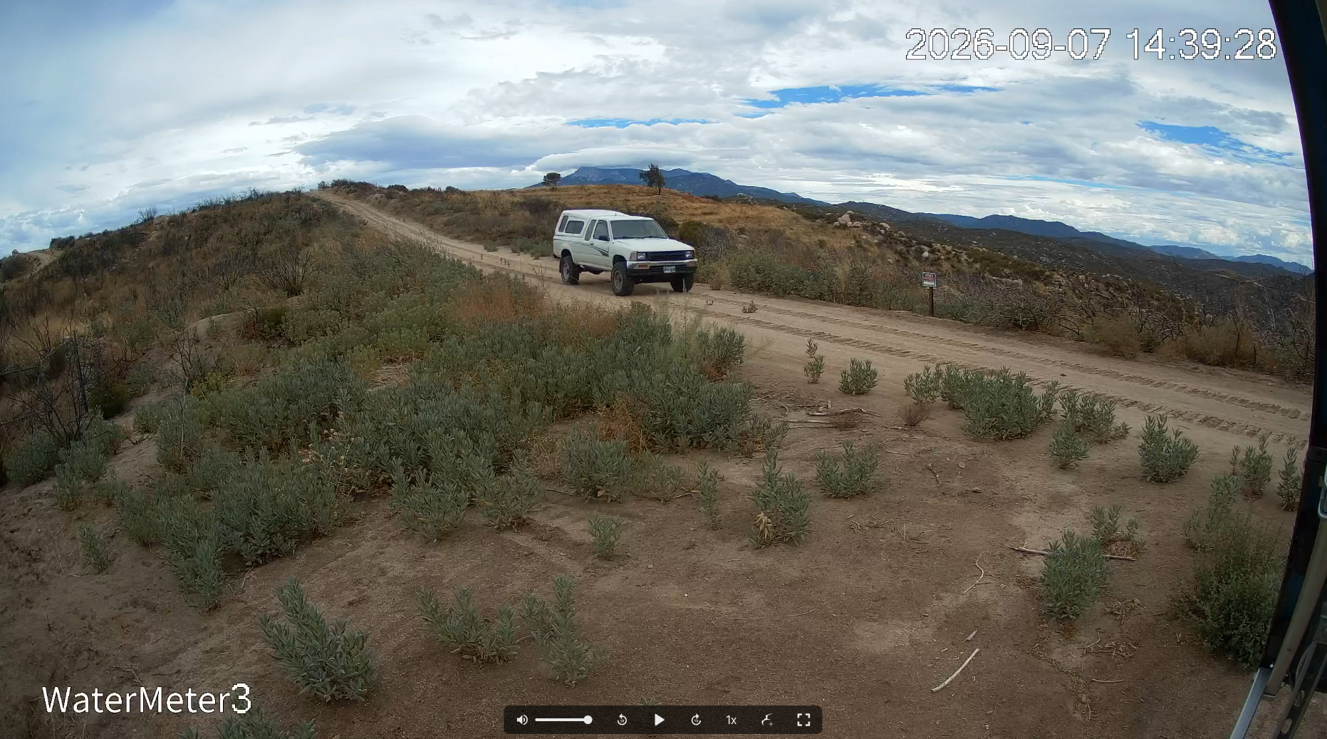

Camera is an AmCrest IP8M-2796EW-AI. The image above is the point Frigate detected a car. Humans are detected around the point of that no trespassing sign. It’s a good example of how large you want items in your camera view.
This is really a horrible camera view and I should use a camera with a tighter view (more zoomed in). But this road ends here, so the only thing the car can do is back up. And if the car keeps going past this camera, there is 2 other cameras next to the road that get a real close view of any cars/people/animals.

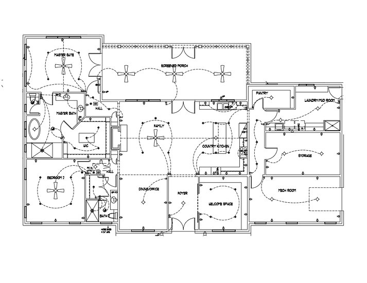

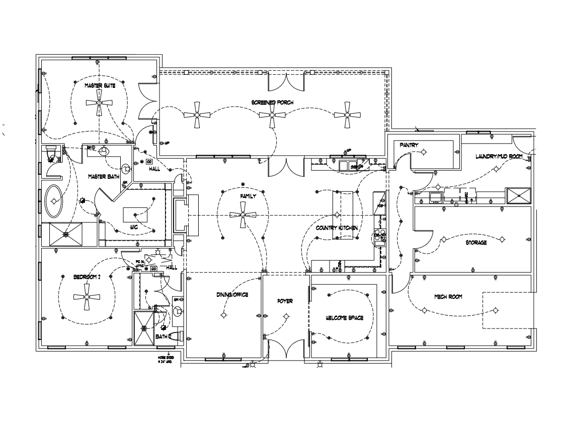

I am looking into cameras. I do not think my plan is good. I will attached the layout of the home. I am looking for suggestions on how many cameras and what type of cameras to get. POE is the only thing that is required. There also will be eight flood lights on the corners.
