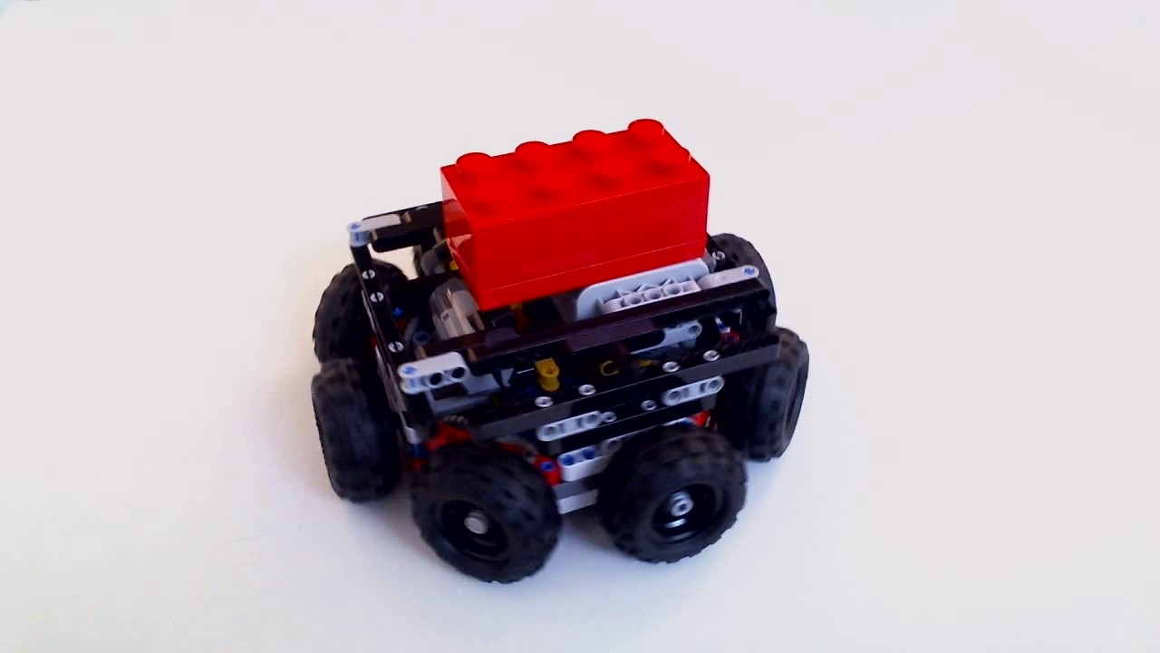

The piece I wanted to use are these 11x11 curved gear racks. With those you can make a 21 studs wide turntable which is enormous compared to Lego’s old turntables which are 5 studs wide. The problem with those 5x5 turntables is that they can’t handle much load unless it is completely centered in the middle. So my old design used wheels instead (8 of them for bragging rights):
This was inspired by a much older creation of mine btw: http://www.brickshelf.com/gallery/Spiller/RoboArm/v0.1.1_-_1.jpg
My first try (shown below) was a complete failure. While it wasn’t hard to make it turn, the motion was not smooth. With a tall figure on top it was especially noticeable. I tried a few different things, but I couldn’t figure out what was causing it.
I then tried my old solution using wheels which does not require as many moving parts. The issue however persisted. I noticed however that the knob wheel which I like to use for transferring power across 90 deg angle gave an uneven transfer of power if they were not hold completely in place. They are gears with 4 teeth and each time a teeth connects it would move the gear back and forth. However using a gear with 12 teeth instead (the black gears in the middle of the image below) did not resolve the issue either.
So I gave up the motorized version. (I did not try using grease, but I would rather not have to use it.) So I made it with manual turning, using the 4 teeth knob wheel seen to the right to make it easy to turn it an consistent amount.
