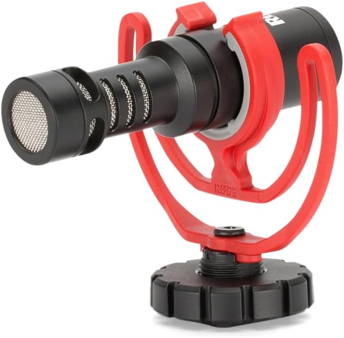

Maybe Rode Videomicro ? Shotgun Mic?
Rode Videomic is already more than the budget amount, and still need a preamplifier/interface

I haven’t seen a video mic that small from rode before
that needs 3v plug-in power from a pc/camera etc
100Hz-20kHz would be not good for deeper pitched voice
and cardiod pattern would not be tight enough to block much background noise
you would need something more like a true shotgun mic
lots more slots along the sides for a tighter pattern
9v battery version to be independent from later devices, and hotter signal
but probably not within budget for rode brand
