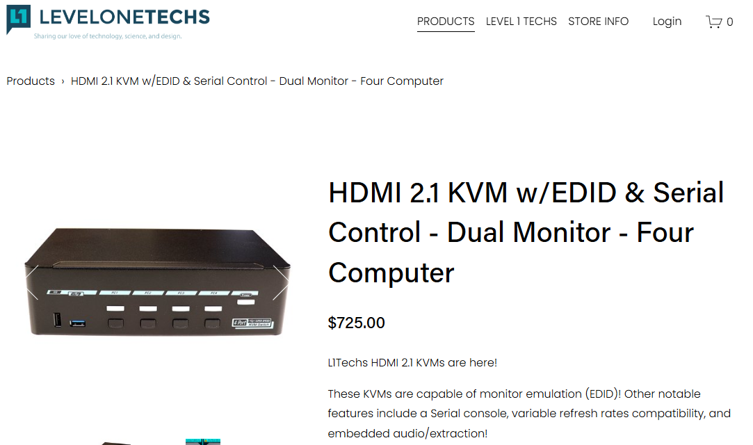

I attached 3 photos of 3 KVMs that would roughly fit my use case (3 computer, 3 monitor ideal). One from Amazon, one from TestSmart and one from LevelOne Techs. Prices from low to high.
The general question is what the increased prices get you? Stability? Flexibility? Longevity? Better QC? It’s hard to tell just by looking at the specs. I’d love any insight into what differentiates these products.

Ooh. Yeahh the closest we have to that is 3 PC 2 Monitor DisplayPort unfortunately. The Quad PC Single/Dual Monitor is the only we have of that type of KVM.
I can explain the differences here.
L1Techs
  • That TESmart KVM is HDMI 2.0 instead of 2.1. So ours goes up to 4K 120Hz (240 with DSC).
  • Ours has a serial control port that can also control the KVM with hotkeys (RJ-11).
  • Ours has VRR support. G-Sync, FreeSync, etc. will all work with the HDMI 2.1 KVM.
  • Wendell has custom firmware that no one else has. For instance, it it compatible with OLED TVs sleep settings → x.com
  • Ours has 444 chroma support.
  • Ours has USB-C gen 2 data ports (which is 10-gigabit), and theirs is USB-B (which is 5-gigabit).
TESmart
  • remote
  • pin code
  • RJ-45 port
  • LCD screen
  • “Mixed” mode
Both
  • EDID monitor emulation
  • USB 3.2 ports
  • hotkey support
