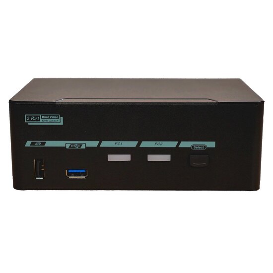

L1 specifically made a KVM that is for these types of problematic inputs. This one here:
Bad news, EDID is DisplayPort 1.2 at the moment (max 4k 60hz) and you have a 4K 144Hz display : /. So even if you did use edid monitor emulation, you’d be limited to 4k 60hz with no freesync/gsync…
The product description has more information for you to read (instead of me butchering it).
From what I was reading, there are different types of EDID, as well, which got confusing. The teredici input and switching seems to be behaving just fine. But being limited to 60hz wouldn’t ruin my day. I don’t need 144Hz to watch Qt fail to compile all day…
It’s the local linux machine that isn’t succeeding at getting a display again after switching.
Would I be able to test the EDID KVM and return the non-EDID one if it solves all of my life’s problems for me?
Hm. We usually don’t send out products without a return happening first, I mean, otherwise how could we guarantee we’ll get it back?
You could purchase the edid feeder and see if it solves all of your problems. If not, we do have a 30-day return policy from our store.
Thanks! That seems sane. I’m perfectly happy to do the purchase-test.
Great keep me posted :+1:
Do you make a displayport kvm with edid for four computers? The linked one only supports 2 computers.
