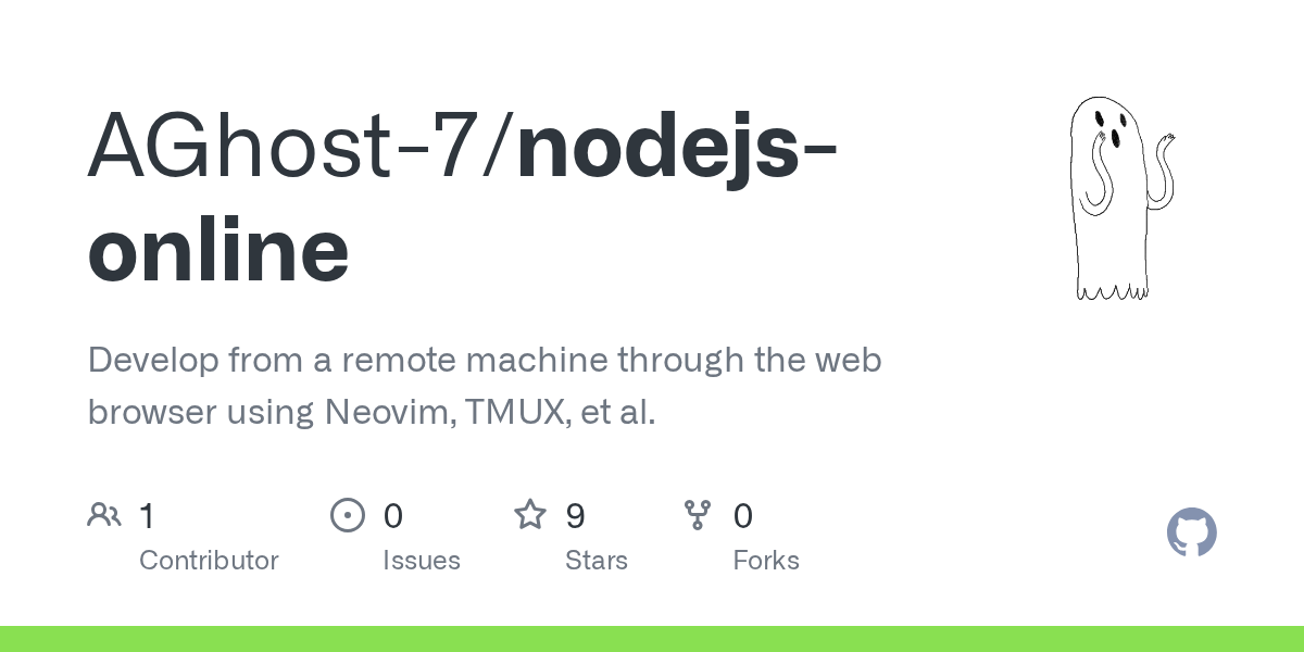

I've been using my development environment from a docker container for a while now (if someone's curious, you can find that here), and today I made it so that I can develop from the browser using a program called ttyd.
Just felt like sharing this.
