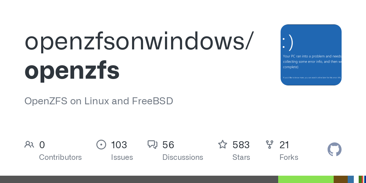

Sorry for double posting. If you are hellbent on performing arcane rituals and doing some really dark magick, here is a forum dedicated to ZFS on Windows (and MacOS):
And more specifically, here are the latest install packages:
Most sane people put a NAS box as a separate storage device, much less headaches. Still, if that is not an option, you could try the above. Sounds like a fun Devember project :slight_smile:

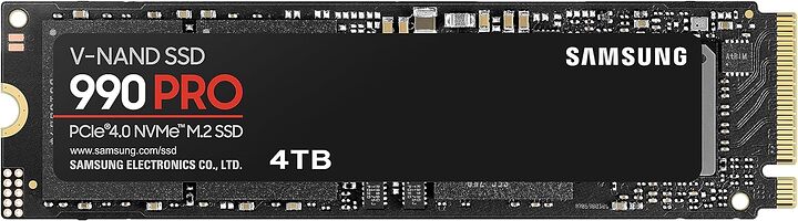

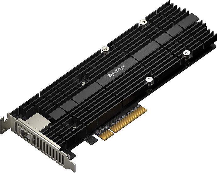

Your simplest option? Buy one of these:
Plus two of these:
Total, roughly $850. Holds so much storage it is likely your server will die before you need more. And of course, a 10 GbE interface is never bad. Setup easily transferrable to another server in the future. RAID Mirror for redundancy and backup. Only drawback is the limited number of PCIe lanes.
