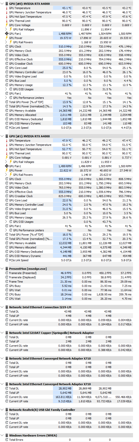

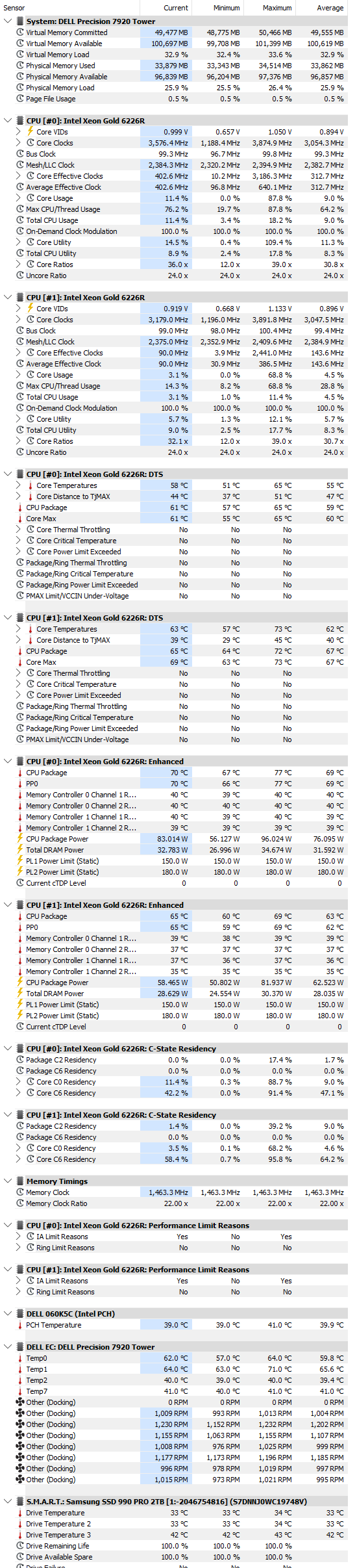

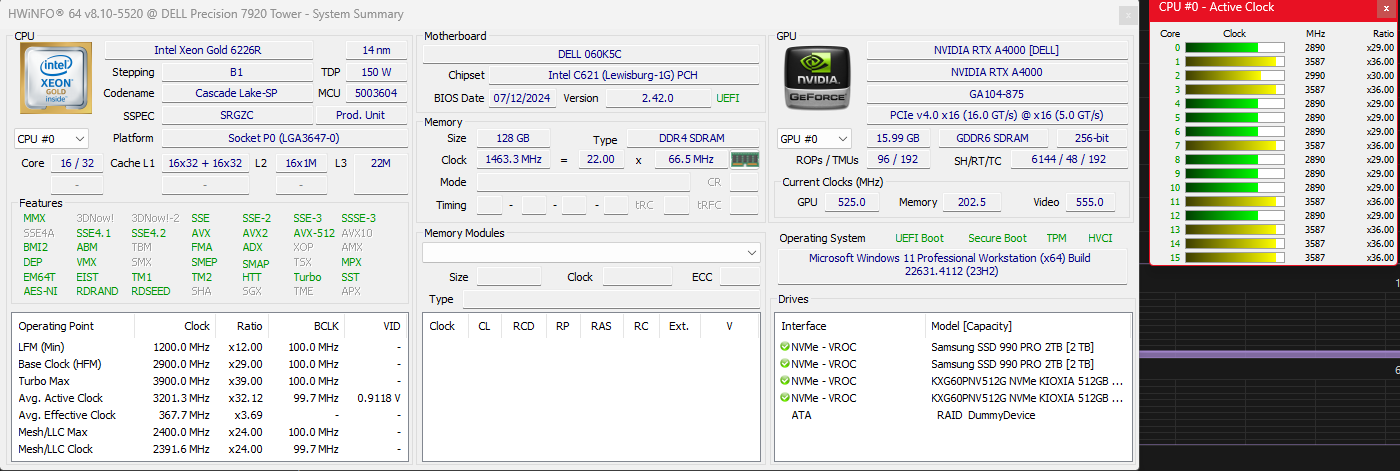

It kind of feels like the memory load on the gpu might be too high? Or the gpu is stuck in 2d mode. can you run hwmonitor while it is sluggish and check what the gpu is doing? just make a screenshot of the gpu part like this:

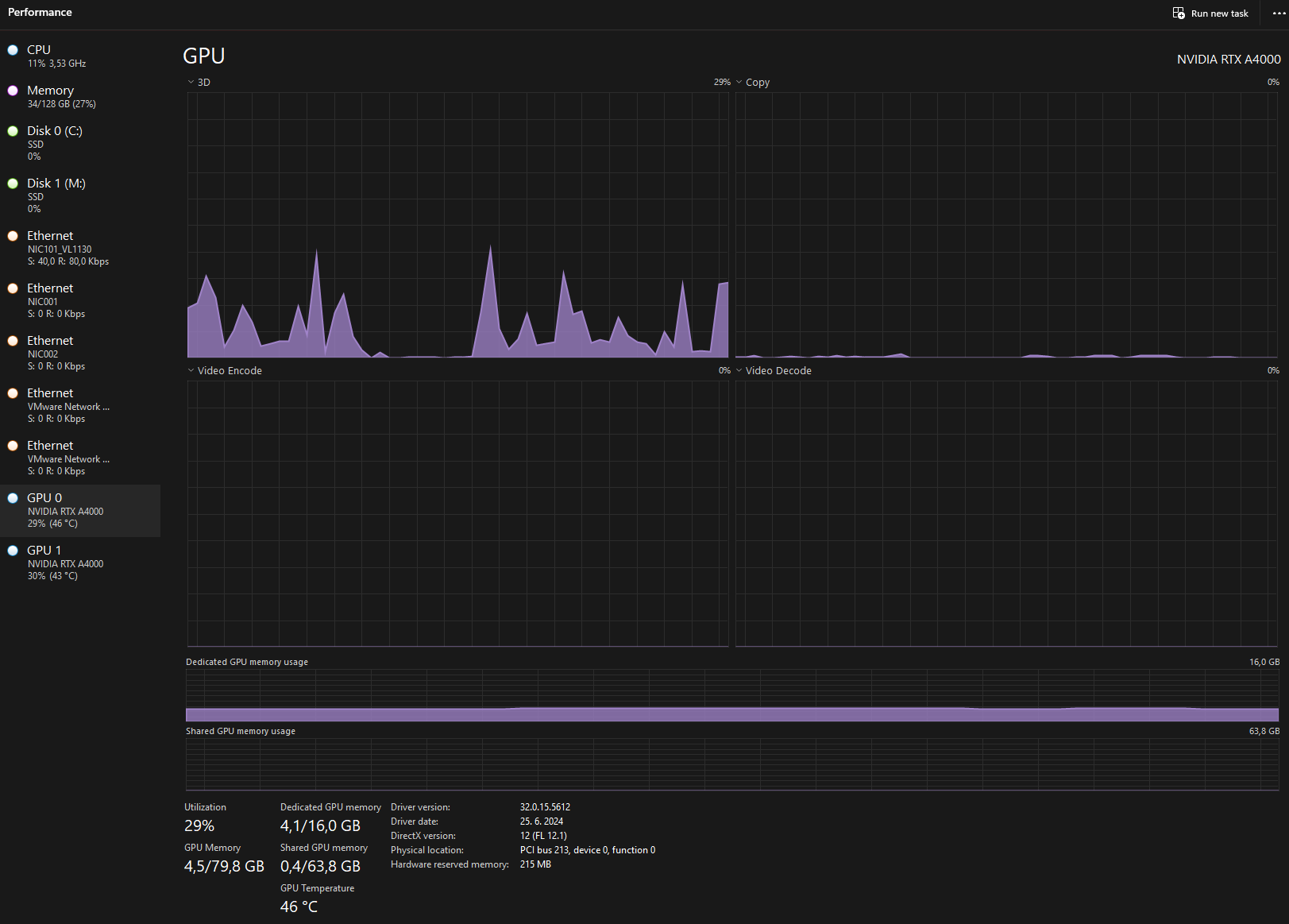

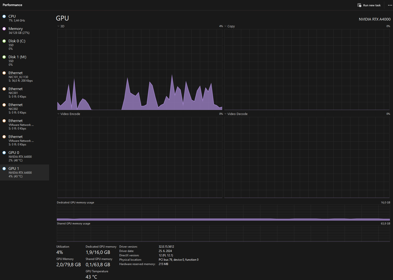

Thanks a lot. I am attaching a few screenshots. I hope it is OK to post those screenshots directly here.
Basically, the machine is running for one day and it is getting unusable. I am also noticing that MS edge es sometimes turning all windows to black, then coming back to normal - is this related to some specific issue? But, in any way, all windows are very laggy when moving them or resizing. For me, it really feels, like I´d be working via RDP on the machine under heavy load.

Gpu seems fine still. You can really rule it out by running a 3d stress test in the background.

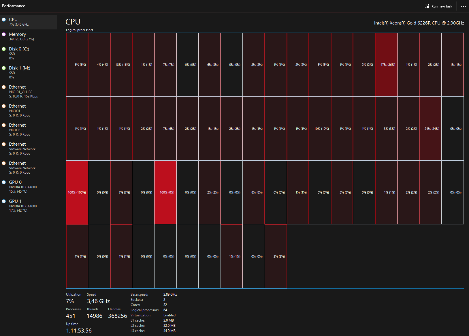

What is really happening is that 2 cores are pegged at 100%. So it feels like the cpu is not working that hard but an application os only running on 1 or 2 threads. Can you use task manager to check what application that is ? With how many cores you have it would only show up as a 3-5% cpu load.
What could be happening is that that application is bottlenecked by cache/memory and that is causing the issue. This could be a browser for example, your cpu is not that fast in single threaded applications.
To solve it we need to know what application it is, an option would be to set the priority of that application lower, in hopes it would help usage of the computer.

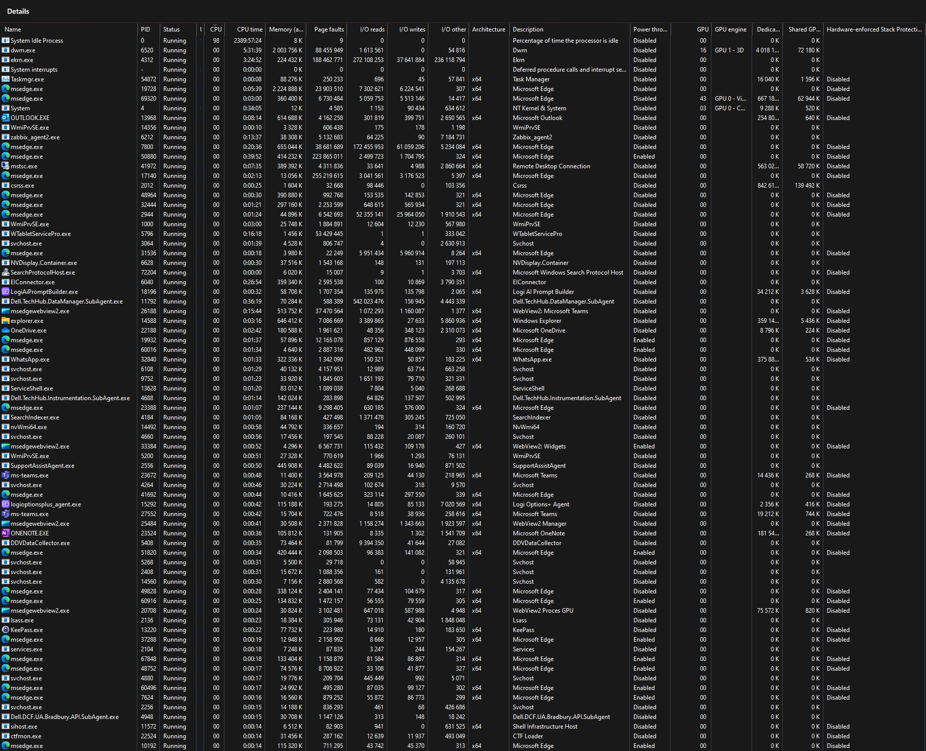

For the processes, I am running a ton of MS Edge Windows. Please, see the attached screenshots. It is possible to fix it, somehow? Any possibility to distribute Edge to use multi core?

This is more of a windows issue, the window manager uses a cpu core fully and a lot of memory. This also causes all the windows to slow down with it because that process is bogged down.
I’ve read up a little on it (you can google dwm high cpu/high memory)
It is caused by an intel gpu driver issue, which shouldn’t be the case here because you are using nvidia quadro’s
Or it can be caused by the driver used for Remote desktop. If your issue goes away when using remote desktop then that is probably it.
