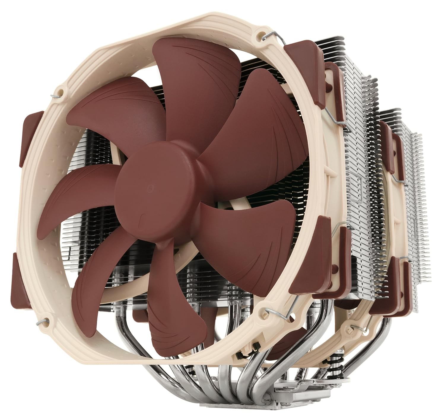

King O Da Hill IMO
There's a lot of love for the Noctua NH-D15, but the Phanteks PH-F140PE seems to be pretty competitive. My Define R5 is a windowed case, so I'm not sure I could bear to look at those brown fans day after day. Everything else inside this case is either red, black, or white. Even so, I wanted to give Noctua a fair shake, which is why I wanted to at least consider their new black/gray redux fans.
