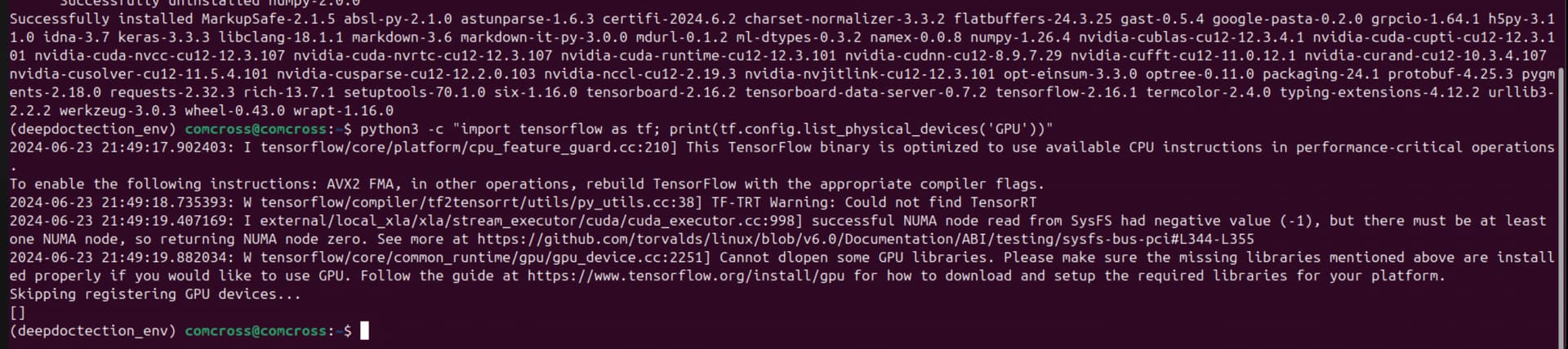

Yes, older versions or not the current ones are a pain a real pain. My issue is that I want to use Tensorflow and when you check the website, it says that is needs NVIDIA CUDA Toolkit 11.8 and cuDNN 8.6.0. TensorRT is optional but we’ll leave that out for now.
The reason It’s so frustrating that it doesn’t really matter how I install Tensorflow, it does not work.
I’ve tried it with a Python Virtual Environment, tried it in the Terminal etc. it does not wants to install it self and is displaying error.
(I’ll attach all my screenshots from not functioning installs at the End, as a little insight.)

Looks like you followed a similar cuda setup as Wendell’s guide. If not this might be tangentially related, it’s written for pytorch, but if you are having trouble installing cuda this might be a alternate.
TF ought to work with newer CUDA versions, take a look here:
Guess we found your issue, try to install the latest CUDA for your driver and then we can follow with getting a newer version of TF installed.
From your other errors, seems like you installed a really old TF version that was meant for python 2, hence why the errors with ( and whatnot lol

That’s a odd error. If you just want to test inferences, can you use pytorch for CPU extraction instead? If the text extraction is good enough, then you can debug building cuda later.
On the topic of cuda, can you check that the nvidia proprietary drivers are installed? OP had it
The package not found error is related to not having the cuda repo
Also if you want to post the text as a code block ``` \n code output here \n ``` to make it easier you can use markdown formatting on discourse
Did you add nvidia repos as he stated at the top of the guide?

Tried your suggested method of using the drivers from the official repos and it worked like charm.
It pulled 535 automatically, I used “nvidia-cuda-toolkit” which pulled CUDA 12 and I installed cuDNN 9.2.0 through the commands listed on the NVIDIA Website.
I skipped the tensorflow thing for now and installed PyTorch, worked like a charm from the beginning on ward.

I don’t get where you got that conclusion from. At this point in time PyTorch is often the preferred framework for most stuff, since TF took way too long to adopt some newer stuff. Both are equally capable, it’s often just a matter of personal preference, but PyTorch managed to get a good grasp in the market.
You are running this code in an empty venv, with no previous dependencies. A pip install torch torchvision should fix this error you’re facing, but you’ll likely see other errors.
Oh neat
Does pytorch scale out for distributed computing? Because that looked like a distinguishing feature for Tensorflow?
Yes:
https://pytorch.org/tutorials/beginner/dist_overview.html
