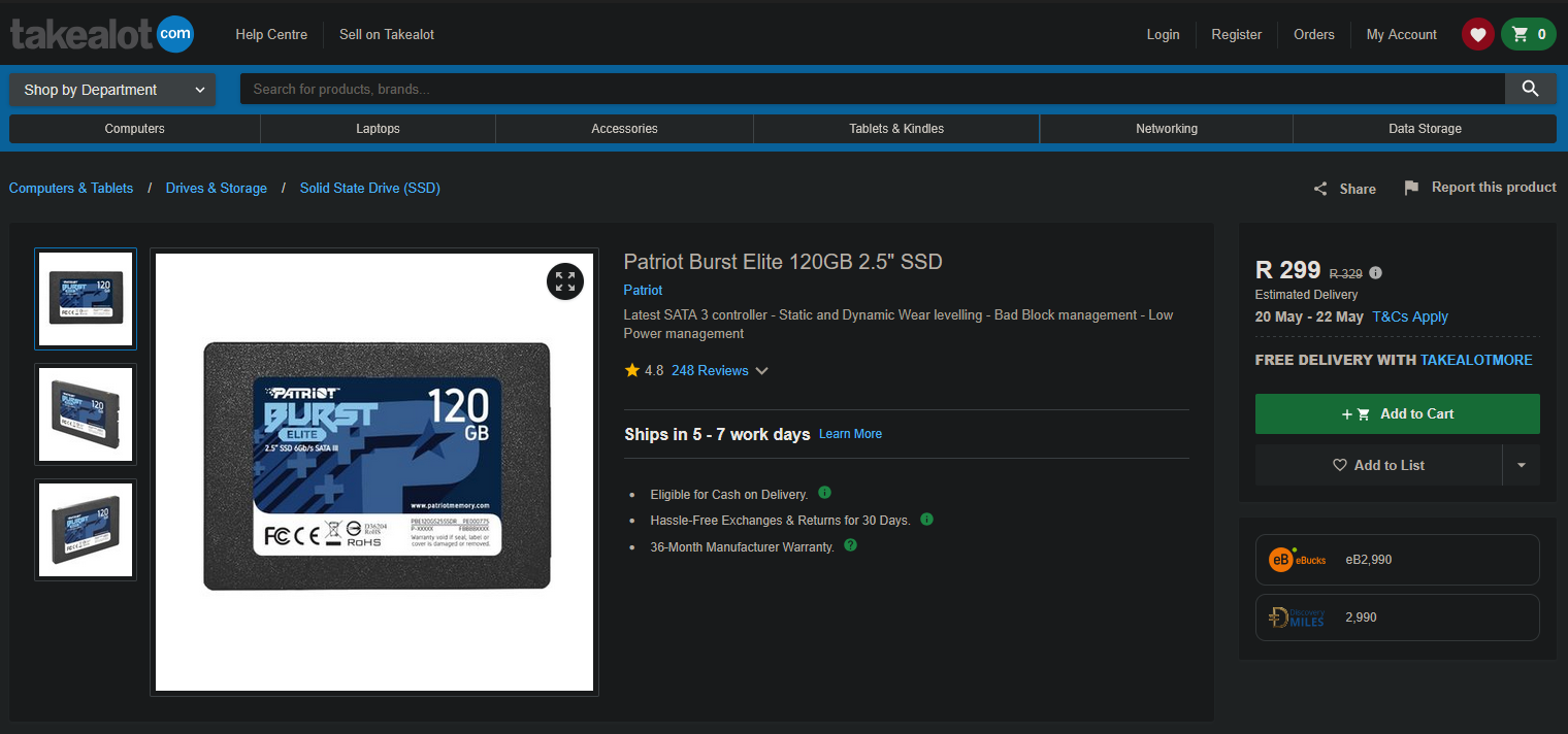

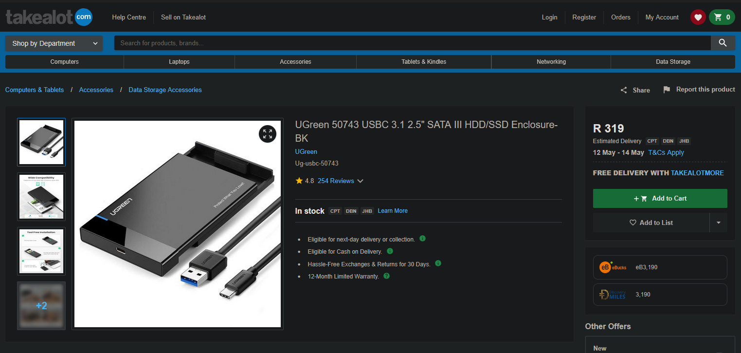

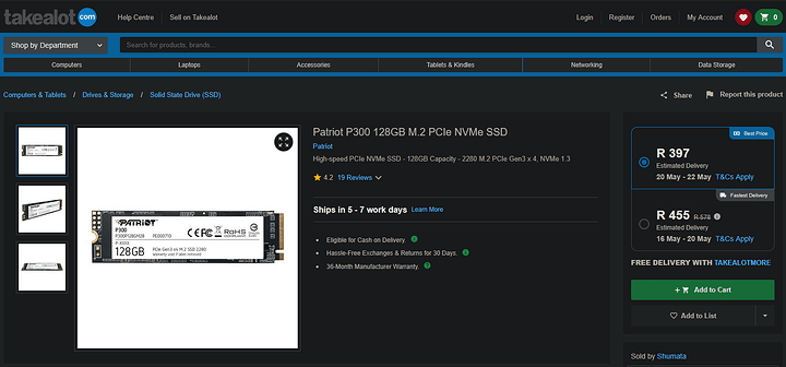

Been looking around to see what I can get locally and below are 2 options and I’m thinking the first option is the best.
I would prefer to purchase locally so it’s easy to return if needed and Takealot has a 7 day no questions asked returns policy.
The 2.5" SSD option is a bit cheaper and heat should not be an issue due to the limited transfer speeds of SATA 3. It is slightly bigger, but not really any less or more convenient than the m.2 option. I chose this enclosure because it’s at least a brand I’ve heard of and used before and it’s using common USB C and A.

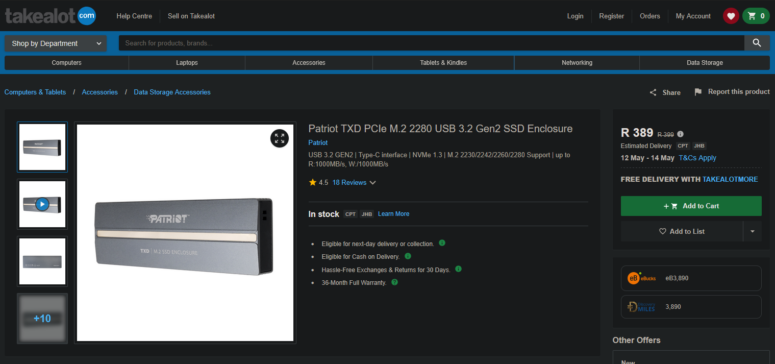

The M.2 option is more expensive and it’s harder to find a 128Gb SSD that is not some e-waste brand in the M.2 standard. I liked the idea of getting the a small 64Gb m.2 2230 with an equally small enclosure, but I’m not really finding that.

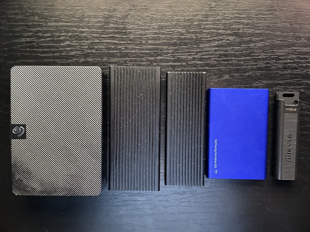

I’ve basically stopped buying USB flash drives. They are generally advertised as USB 3.2 gen whatever, but work like crap, less than USB 2.0 speed.

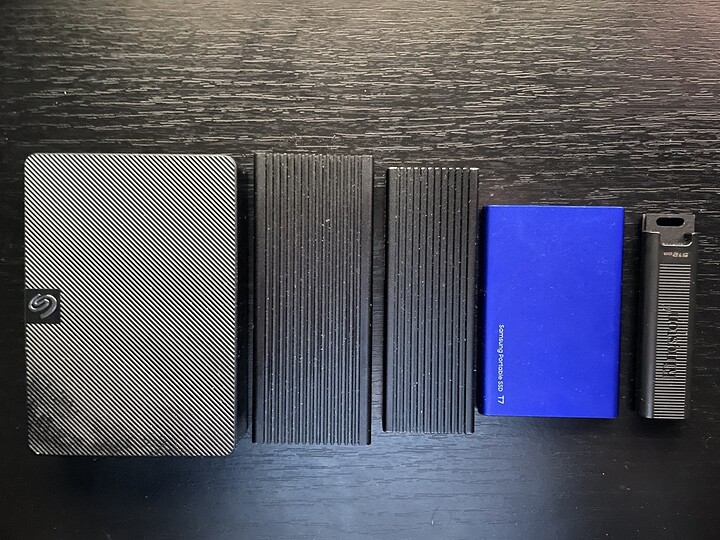

My current lineup is
  • 2,5" HDD for bulk data
  • couple of m.2 SSDs in an enclosure, good for fast transfers and made with old SSDs
  • Samsung T7 SSD, super fast, compact
  • Kingston DataTraveler MAX, super compact, just a bit bigger than regular USB drive. Basically an SSD, but not as fast as others
Most of the time, I just grab Kingston and go. Apparently Transcend makes even more compact one with 5 year warranty. But I’ve never seen it so I cant say much about it.

That said, although the M.2 option is slightly more expensive, I’ll go for that as it’s probably slightly more future proof. I doubt the 2.5" standard is going anywhere any time soon, but with an M.2 drive you can at least see what is printed on the chips :wink:
