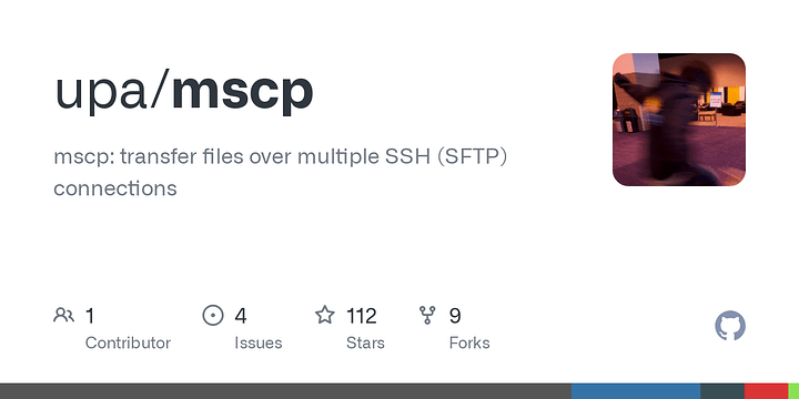

After researching this I really think that this may stem from the 4K block limit on Ext-4 as well as what I perceive to be a hideous lack of multi-threaded optimization in basic CLI tools like CP and DD.
Doing a single dd with bs=1M on my PM9A3 is actually SLOWER than using MSCP to 127.0.0.1.
If someone else wants to try this I’m curious the results:
Install MSCP and send a large (like 20-30GB) file to 127.0.0.1 with adjustments to the -u and -m parameters based on how many cores/threads your box has (I tried -u64 and -m64 in my case)
compare that to using dd if=X of=Y BS=1M

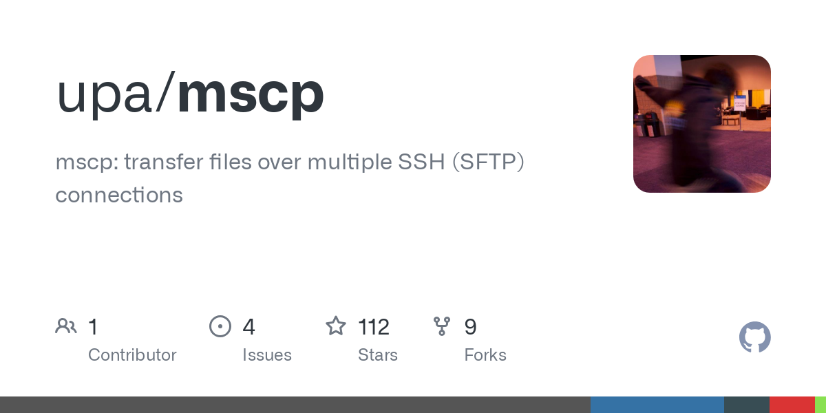

Hey I’m not the only one having an issue! awesome!
There is similar functionality in a tool called MSCP:
I actually use MSCP to copy files locally. What is weird is that when I copy them to a regular Ext4 volume they copy faster than regular cp but nowhere near the speed of the drive.
However, when I copy to a ZFS formatted drive, even with ARC disabled, it’s getting up near the drive speed spec.
I still believe that there is a significant lack of optimization that I’m dealing with here.
