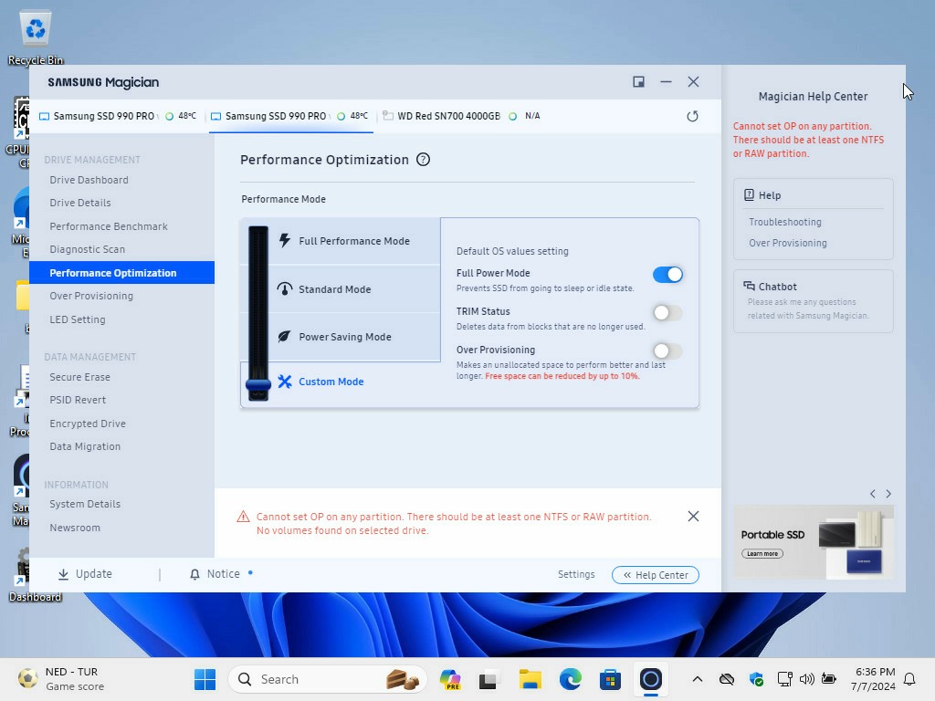

I found a post elsewhere that suggested enabling Full Performance for each of the SSDs to prevent them from dropping offline, but right now that is not even happening, the machine is completely kernel panic’ing right away.
When I boot to Windows 11 on the WD Red NVME SSD, I ran various benchmarks Cinebench, etc, I could not get the system to fail for over 20-30 minutes. Whereas in Linux, I can get an almost immediate failure when I try to btrfs balance…
Are there any known issues with Linux and Samsung 990 PRO 4TB drives? I could try some other NVME drives but not sure if that would be a waste of time or not.

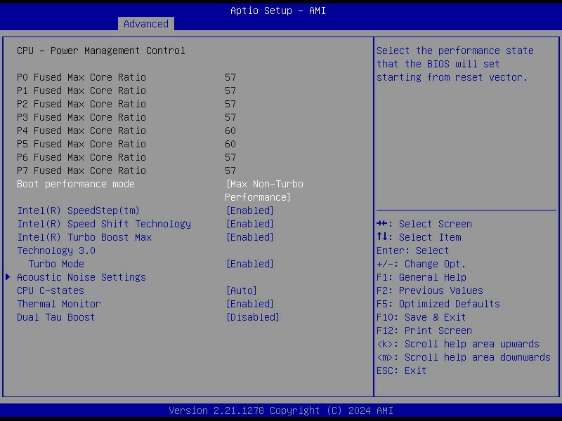

What happens if you reset to default settings and disable the following:
Disable Intel Turbo Boost Max and there also seems to be something that’s called “ASUS Performance Enhancement 3.0” that you also can try to disable.
I’d also try to set “Performance Core Ratio” to [Sync All Cores] and the same for “Efficient Core Ratio”.
Boot performance mode → Max Non-Turbo Performance

this screen
set all core ratio limit lower, 52/53 and intel default should be here
and dram to 4200 if 2 dimms per channel
Updated, I could set 52 for the P-core limit but not for the E-cores, going to untar some backups to see if the crash recurs.

Thank you for the suggestions and pointing me in the right direction, never have I experienced an issue with a CPU before…
Follow-up & questions:
  1. By enabling these features, I will gain stability (awesome!)
  2. Is it worth exploring an RMA or will another i9-14900k have the same issue due to this series of chips being defective?
  3. When setting the ALL-Core Ratio Limit to 57 and 44 respectively, approximately how much overall performance is lost?
  4. Will the CPU be stable with p57/e44 ratios moving forward or will it degrade over time such that I would need to reduce the ratios even further?
