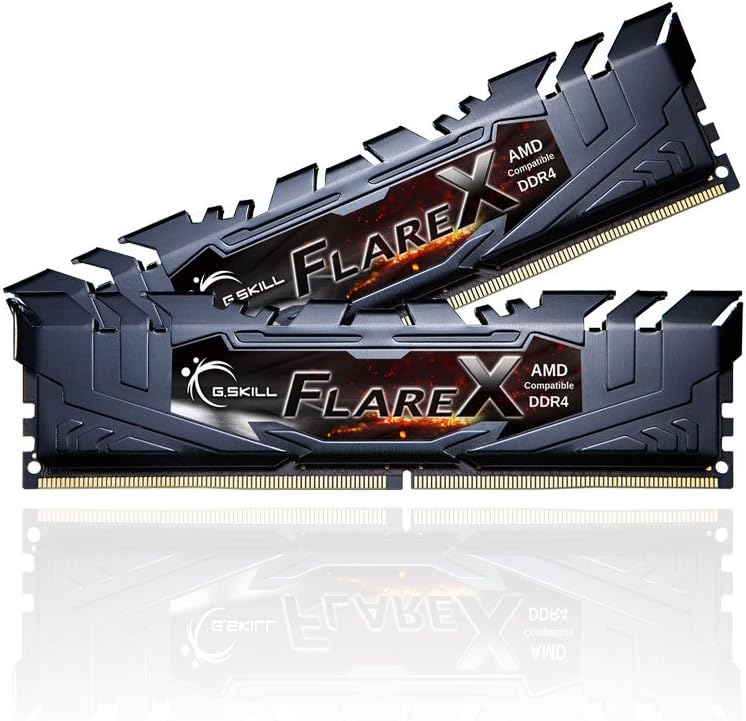

Gskill do have the Flare X series that was built for Ryzen, but even those don't support 3200 @ 32GB currently.

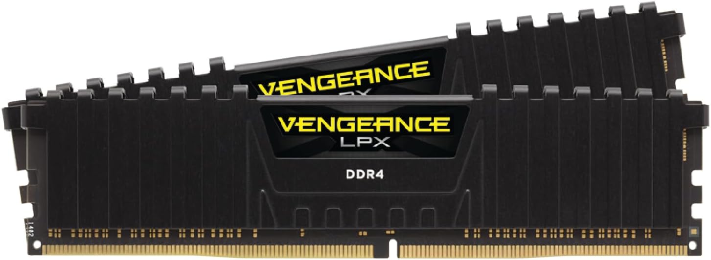

As for ram - by all accounts Corsair is the worst choice possible. People on mass have been complaining of the ram not being able to pass 2933.

So then I guess I will have to make due with 16g right now. The 'built for Ryzen' Gskill FlareX are selling at a 100€ markup over here, so I'll try another kit first. Anyone got experience with the Ripjaws V Series - the are listed in the thread linked by @Ungari as B-die?

I have that cosair kit at 3200 mhz.

But G.skill Flare X or G.skill Trident Z is what i would recommend.
