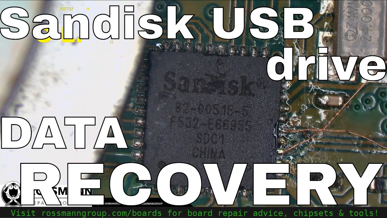

I don’t usually watch his stuff, but I saw a Rossmann vid where he did this:
A bit more intense than just the connection broken though
