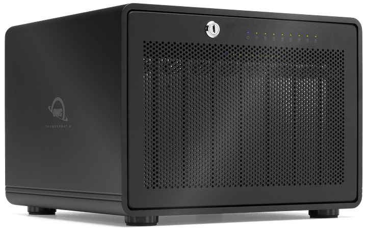

I ran Scale on a NUC for a few years with an 8 bay thunderbolt DAS.
It worked great. No dropouts, no strange issues, nothing. Just had to make sure the device was plugged in at boot, since it behaved strangely if you hot-plug, but I think that was more about the JMC575 controllers residing within the thunderbolt system than anything else.
I have been thinking about getting one of these from OWC and using one of the Thunderbolt/USB4 ports on my X670E Pro Art mobo for something more than bragging rights. Coming from a lifetime of mac use, I have had a lot of experience with OWC and have found their stuff to be top notch. Considering Thunderbolt is PCIe I want to do a ZFS pool on it as well. Still thinking however.
It comes with OWCs own software RAID, there is no hardware RAID anything inside this device. It can also be ordered without their Software.
That’s the exact model I’ve had for about 3 years now, I think? It’s solid.
Extremely reliable, and works great on my new B650E Taichi.
This device presents disks as JBOD, so you can do whatever you want with them.
When I ordered mine, it didn’t come with any software that I needed to install. I just threw disks in, plugged it in and there were 8x 8TB disks in /dev.
That’s great to hear, you have calmed my last misgivings. I’ll go ahead and order one.
I should have been more clear, it can come with Softraid, or it can come with no software. For my purposes I am ordering the no software version.
