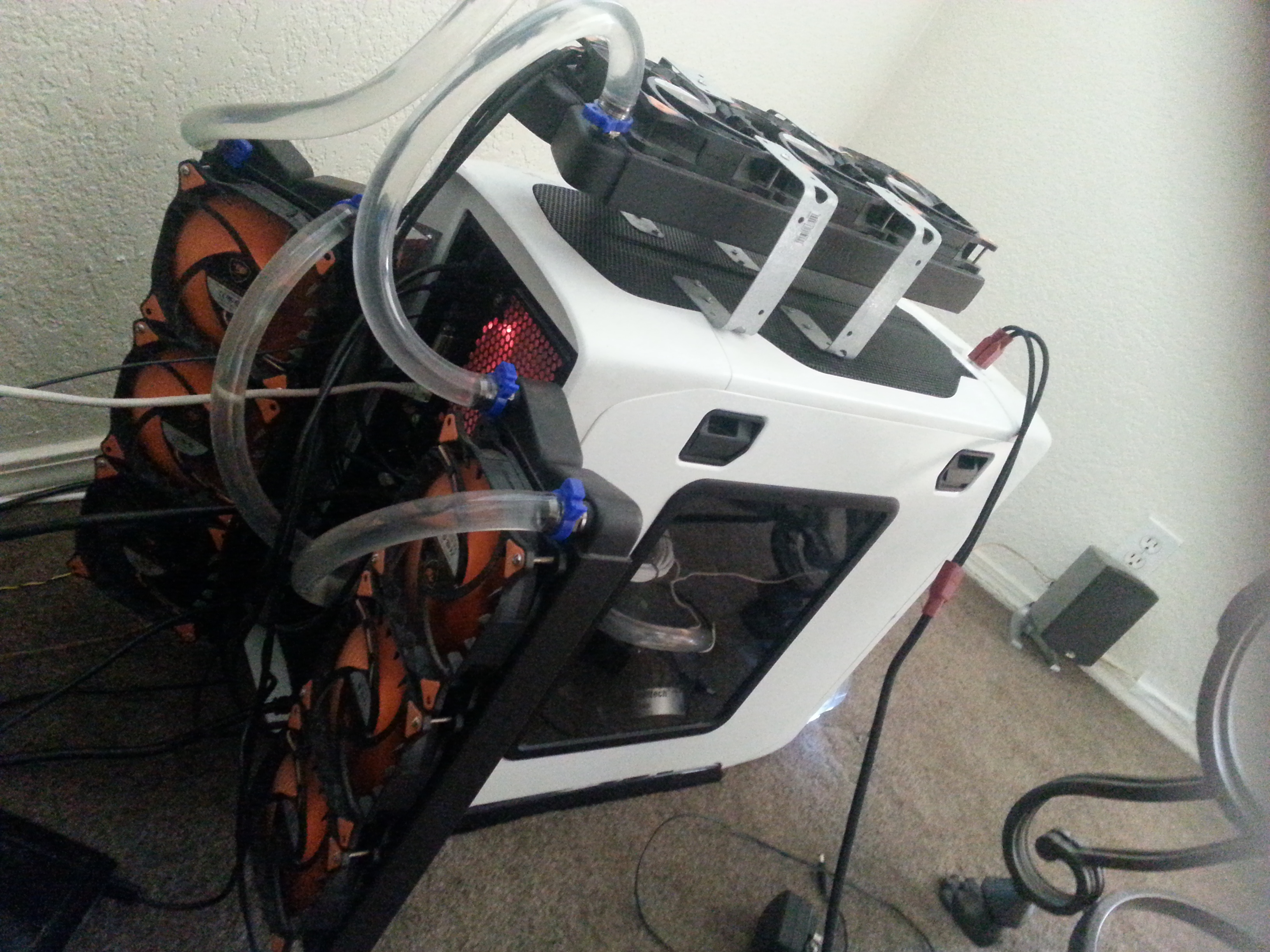

I was absolutely thinking about mounting the Res on the outside after seeing something like this over on Paul's Hardware. I think I could probably use the reverse side next to the IO shield where it would normally be inside the case. Annnd it shouldn't interfere with my GPU inputs.
Just working out a way to route the tubing into the case again without it being in an area it could be damaged or cut by the metal on the case.

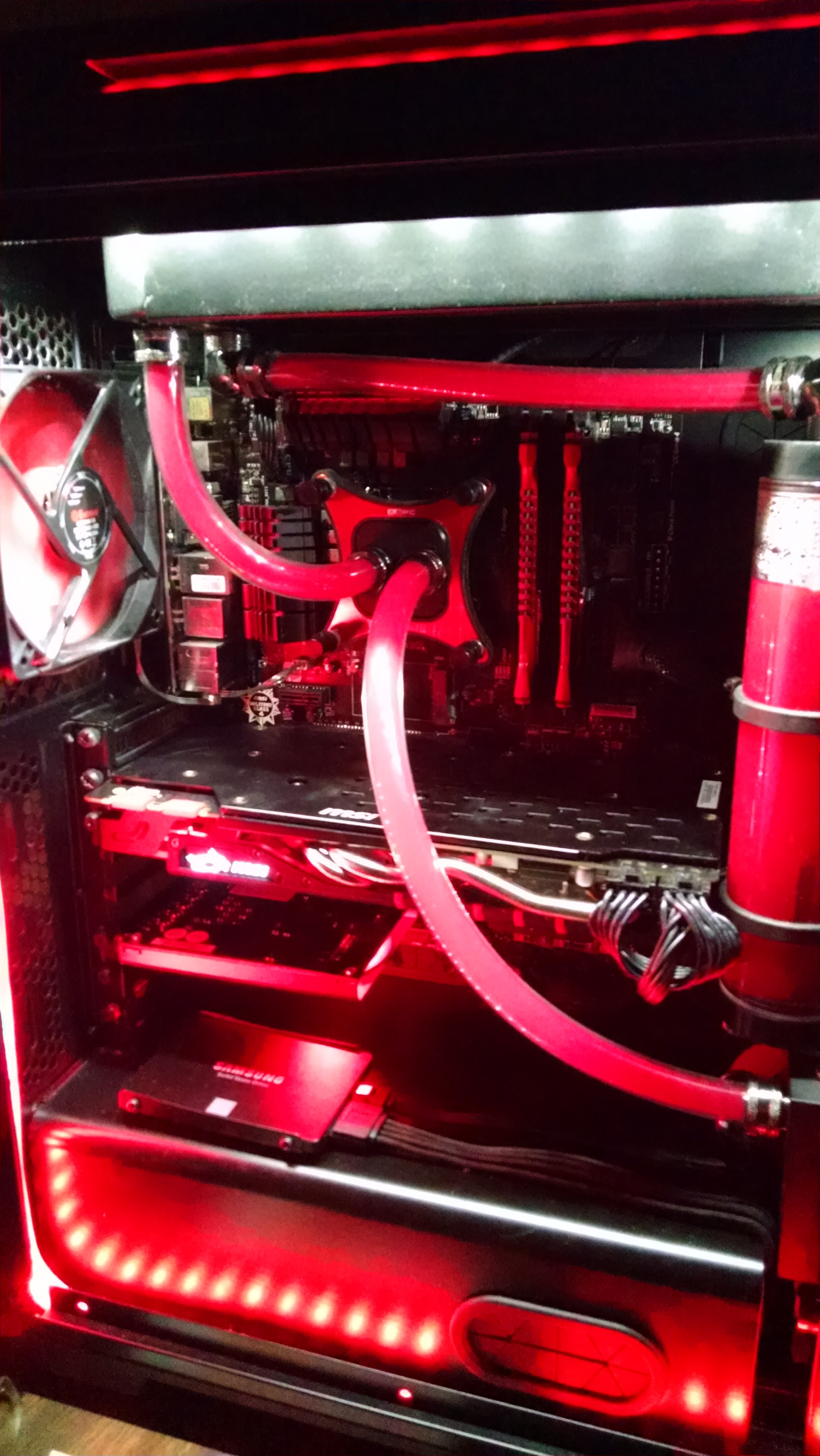

you sure you don't have room? this is my loop with a MSI 980ti in an Enthoo Luxe (pretty sure internal dimensions are identical)
the card is 10.6 inches and I have exactly 1/16 of an inch to spare. my res is a standard 50mm BitsPower res.
Edit: nevermind I just looked the MSI 980 is longer than the 980 TI what in the actual fuck?

Haha of course the Ti card is somehow shorter. I'm thinking a more nonstandard mount outside the case for both the res and punp. Might be interesting

I'm actually going to see about adding a port to route the tubing into the case from the backside.
