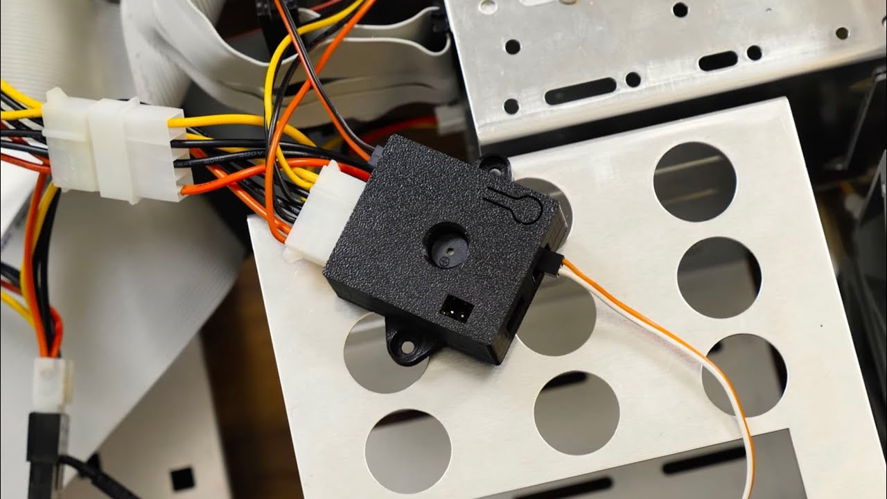

Even though this has nothing to do with HDD’s, I cannot resist to post this clip which is a clever assembly of old school stepper noise:
