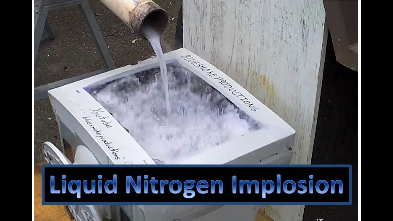

Apparently it can explode as well and
“Also, don’t think a CRT which has been powered off for a long period of time will be safe - the CRT will slowly continue to build static electricity just due to the Earth’s rotation and magnetic fields.”

Jesus that video made my skin crawl. No blast shield, and with kids nearby? Please nobody do that ever.
