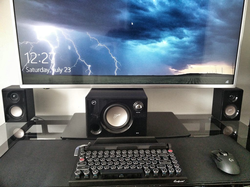

More updates to the review. Some initial photos have been added. Those photos are mostly quick cell phone pics of the more important things (I absolutely promise you that you'll see no glamour photos of the monitor coming from me - sorry but I just don't care that much!). I still need to pull my DSLR photos off of the memory card and bring in some secondary pics (things like menus, etc.).
