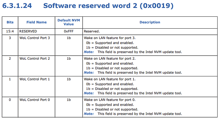

edit: I have now tested this, from the x710 datasheet this value is preserved by updates which would explain why your switching to PF_Alloc.txt doesn’t reset it.
Then referring to PF_Alloc_WOL_DIS.txt
    BEGIN DIRECT
	0x019 : FFFF ; SW Revered Word 0x19 Disable WoL
    END DIRECT
I don’t know if it would matter if a 4 port config is used on a 2 port device but I think it’d be either FFFC (2-port) or FFF0 (4-port):
    BEGIN DIRECT
	0x019 : FFF0 ; SW Revered Word 0x19 Enable WoL
    END DIRECT
edit: I have tested on a Dell 2 port card with FFF0 and now see Supports Wake-on: g
@sulphate Thank you for the excellent finding! I tried it and got WOL enabled.
