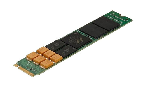

MTFDHBG400MCG-1AN1Z-lg__00804
these drives have extra capacitors, (THE YELLOW THINGS) to write out data (from cache) if they loose power. that is all that PLP actually is. everything you talk about is not a requirement of PLP. even though it usually exists.

Exactly. That is why PLP drives are usually faster than none PLP drives. They have yellow capacitors that enable the drive to send the ack even though the data is not on NAND but only on DRAM.
