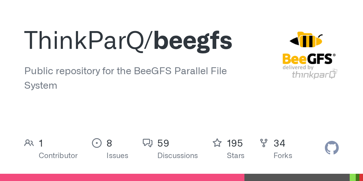

Far as I can gather BeeGFS is only useful in clusters of servers Plus it’s not open source (if free) so doubt it’ll gain much market share.
BeeGFS is similar to HDFS, it is meant when you have a datacenter worth of data to store and use.
There is the source code:
My bad, thought it only free to use
