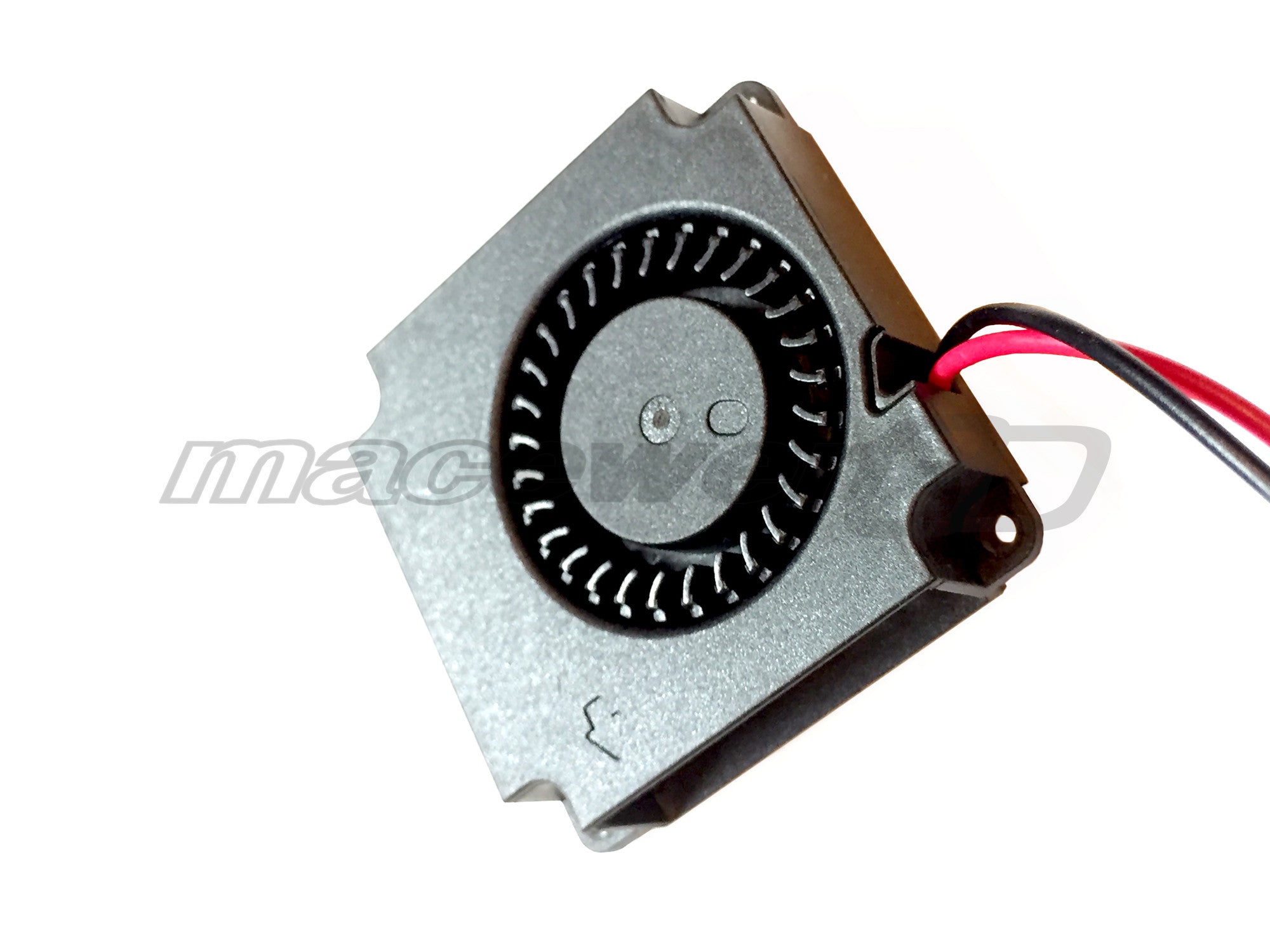

Urgent question does the second smaller fan that’s on the hot end suppose to be turned off aka not spinning?
This one:
The bigger front facing is working fine.
OMG EDIT: Just as I posted this I noticed it turned itself on -___- well that answers the question.
