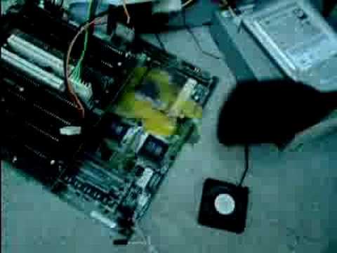

Had an idea of taking stock cooler and attaching a small frying pan to it. Then my pc could be cooled by eggs.
