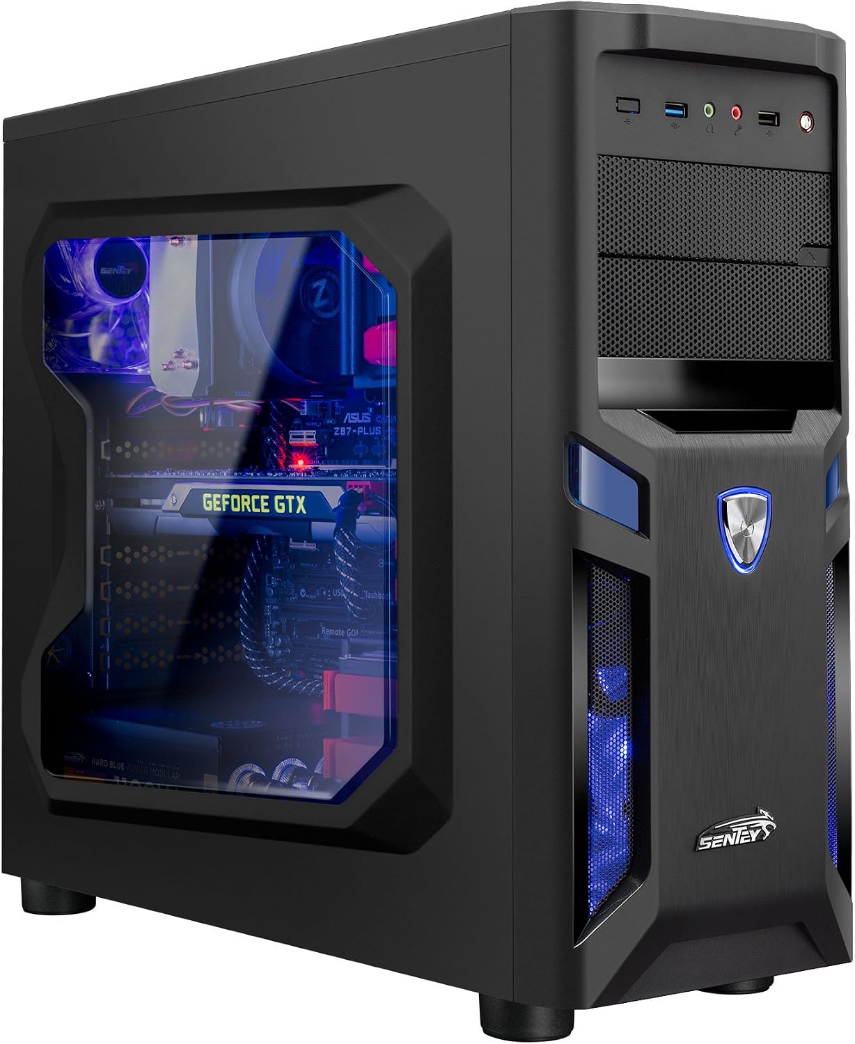

what type of case do you have? is it a "silent" case?
is 63 C good ? ik for a fact its better than 79 C XD
OKay,, 63 is still too high, not, "you are about to melt" high, but too high. I would pull the current thermal paste off with alcohol and then reapply it using the "pea" method in the dead center. you may want to go out and get some arctic silver. (only if it is close if you have to drive too far, or order it, it is not worth it just for thermal paste.) and be sure that the cooler is properly seated. Try your rendering without an overclock to see your temps. THEN when those are down, overclock and then do a burn-in of that overclock using prime 95
