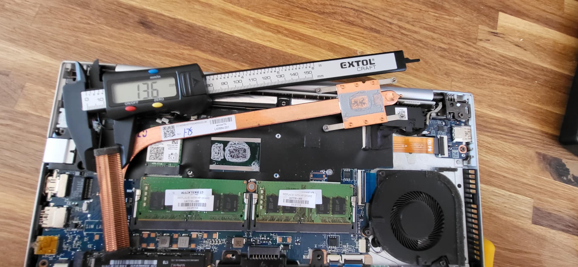

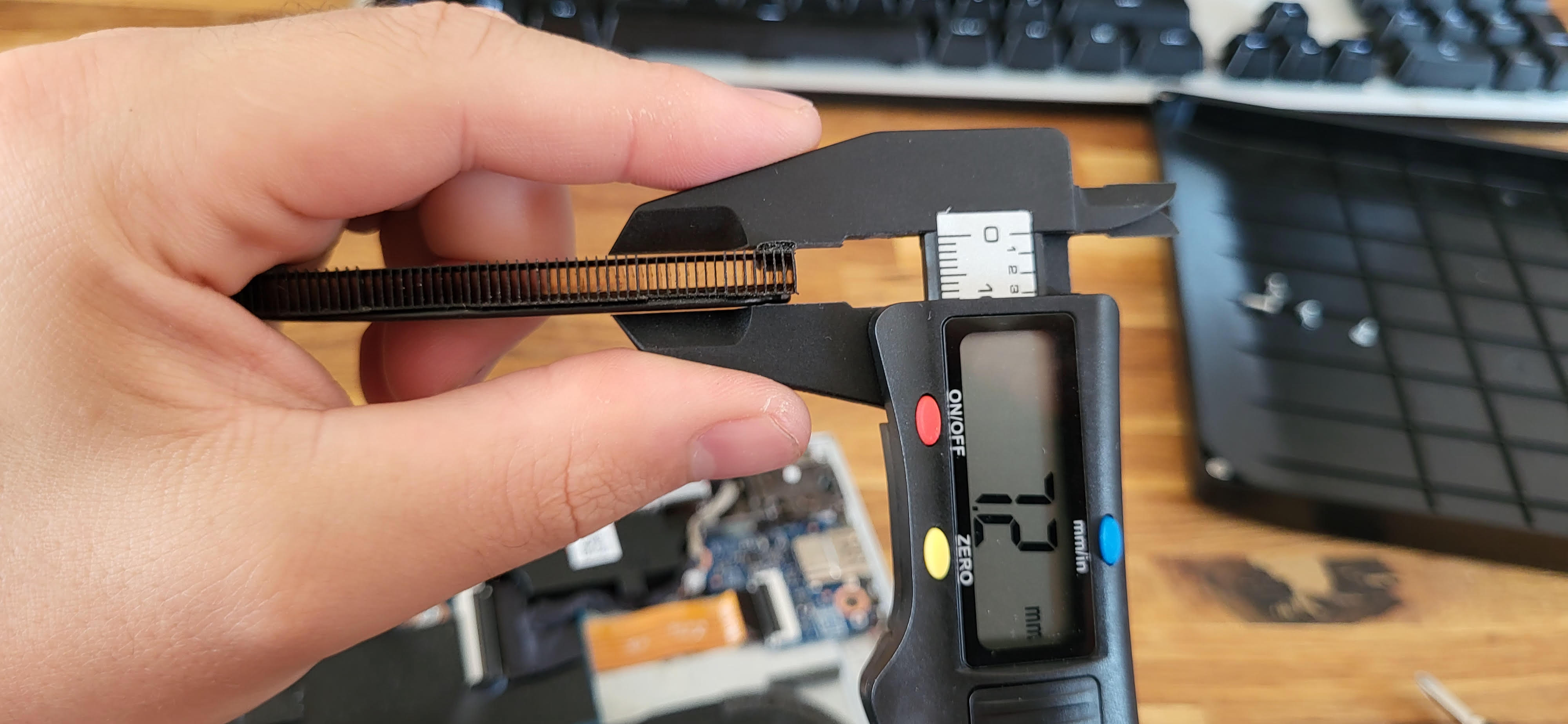

Looks something like this, in case of undersized heatsink in HP probook 430 G7 with i7 10510U (nominally 15W TDP, run at 25W for <90s). Also got irritatingly slow this year and openwmonitor showed temps of 100C at package level under short load.
In this case problem was combination of hot cpu with high TDP, undersized heatsink and dried out thermal grease. Cleaning lowered temperatures bit and prevented thermal throttling.
Still irritatingly slow, just not as much.
Will get fedora treatment once I discuss it with fellas from IT department.
