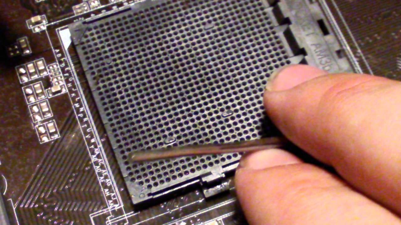

I was cleaning out my father's desktop.
I tore it down to the cpu.
It looked physically Damp?
I stuck my finger into the corner of the bottom of the cpu.
And when it came back, the corner of the cpu looked 'less' Damp.
So I looked at the socket.
And it just sorta SEEMS Damp ish...
I can't Feel it with my fingers tho...
It's got me concerned tho.
His computer seems to have the problem of randomly shutting down
That's why I was cleaning it.
But the shutdowns would only happen every few days completely randomly with no pattern

You can see a color difference between the left and right sides of the socket

Looks like there is some sort of liquid leakage which most likely came form the water cooler which probably had leaked at some point.
can a cooler only leak every now and then ?
would it not be some slow constant?
dunno but i have no experience from watercooling so i got no idea. just common sense what tells me.
Its a long shot but it could if it is expanding or moving is some odd way when on and heating/cooling. Or some freakish super slow leak that is only caused by some odd vibration. Super long shot but yeah i guess possible.
YUuuup
If it's a high pressure leak and if it has a variable pump speed, yes.

That's not the case I guess. In one of the pics he posted there are some visible screws on the copper plate of the cooler "corroded" by the liquid inside the cooler leaking. Also the noise coming from the cooler working is due to bubbles (as KuramaKistsune said).
@SoulFallen To mount the 212 the AMD mounting should be unscrewed from the board so a backplate is needed, unfortunately.
No I'm pretty sure that was just a bunch of thermal material goop spilling into the head of the screw
