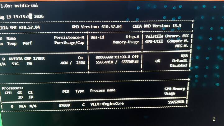

I have one and two are on the way mine ist soldered and is working as intendet I run qwen3.8-27b and could not be Happier :slight_smile: I let Codex made it unlock under Unraid.
Main goal is 2x for 128gb vram as llm and one for comfyui

Average 111.3 tok/s
Decode comparison
110.4 → 111.3 tok/s
Only about:
+0.8%
So decode performance is essentially unchanged.
That is actually useful information, because it makes the prefill result much more interesting: this does not look like a general 3–10× GPU performance change.
The huge improvement is specifically in the prompt-processing / long-context execution path.
Summary
Metric Before After
Model Unsloth GGUF UD-IQ4_XS VnimanieAI W4A16
Backend llama.cpp vLLM
Quantization UD-IQ4_XS GGUF INT4 W4A16 G128
Parallelism dual-GPU llama.cpp TP2 + EP
PLE normal GGUF execution CPU offload
Speculative decoding MTP MTP4
8k Prefill 727 tok/s 2,476 tok/s
32k Prefill 618 tok/s 2,545 tok/s
131k Prefill 353 tok/s 2,443 tok/s
262k Prefill 222 tok/s 2,295 tok/s
256-token Decode 110.4 tok/s avg. 111.3 tok/s avg.
262k Prefill Gain 10.34×
The current VnimanieAI INT4 W4A16 + vLLM TP2/EP + PLE-offload + MTP4 stack is therefore an easy winner on these two CMP 170HX cards.
Decode remains around 111 tok/s, but long-context prefill has gone from being the biggest weakness of the system to one of its strongest points.
A 2× CMP 170HX GA100 setup doing ~2,300 tok/s prompt processing at the full native 262k context while still decoding at ~111 tok/s is far better than I expected from these cards.
The complete cache-free benchmark sweep took:
9 minutes 23 seconds.
Well, for what it’s worth, I was getting ~800t/s prefill on 27B with Q6 in llama.cpp with a single card, but with INT8 in vLLM I get well over 3000t/s.
Try a W8A8 model - these cards are much better with hardware INT8 calcs.
