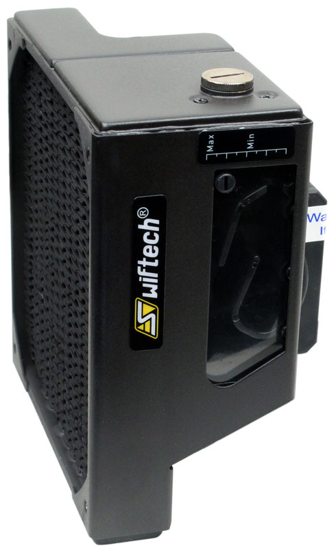

Another thing with aluminum rads is that they are noticeable worse compared to copper/brass rads. Yes they really are, a proper single 120 mm copper rad will beat an alu rad any day and be noticeable quieter as the fan don't have to run as fast. And copper rads aren't very expensive, EK/Alphacool/Swiftech are all very good and affordable. A single 120 or 140 Swiftech would have no problem cooling a 9590 for example. Swiftech also makes stuff like these:
Check out their site for specs etc (seems to be on sale) http://www.swiftech.com/MCR140-X.aspx
It's a 140 proven copper rad, a reservoir and a very decent PWM pump all in one. No coolant, connectors or any blocks included. Should be more than adequate to cool a 9590 with an ordinary CPU block. You'll need a 140 fan, connectors, some tubing/hose and a CPU block. With a copper block all you'll need is deionized water and some anti bacterial like a silver coil and you'll be set for a long time. Can be reused/re-purposed for GPU cooling etc when you move to a new computer. Yes more work than a off the shelf AIO, but also better/more flexible. If you want you can put quick dis-connectors on it/the tubes/blocks for it to be very easy to service the computer. I have tested Swiftechs own brand and they are very good. Expensive ofc, but good. I think EK has plastic ones that should be cheaper. The MCR140-X rad is about 12-14 FPI so you won't need a high rpm fan. The mid rpm EK Vardar 140 would probably work very well and last as long a very long time (double ball bearing).
