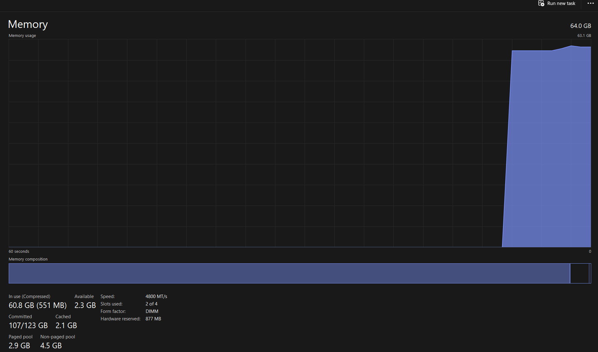

Consistent Memory Leaks on W11 not coming from userland, not visible in task manager

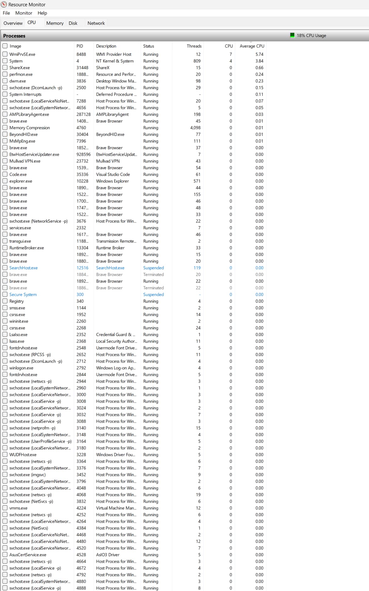

If it continues to happen try resmon.exe to see what it is doing

Had this problem on some Ryzen servers in the past on Linux as well, a few kilobytes of memory was detected as corrupted in /proc/meminfo and memory usage was growing despite nothing showing up in htop/ps.

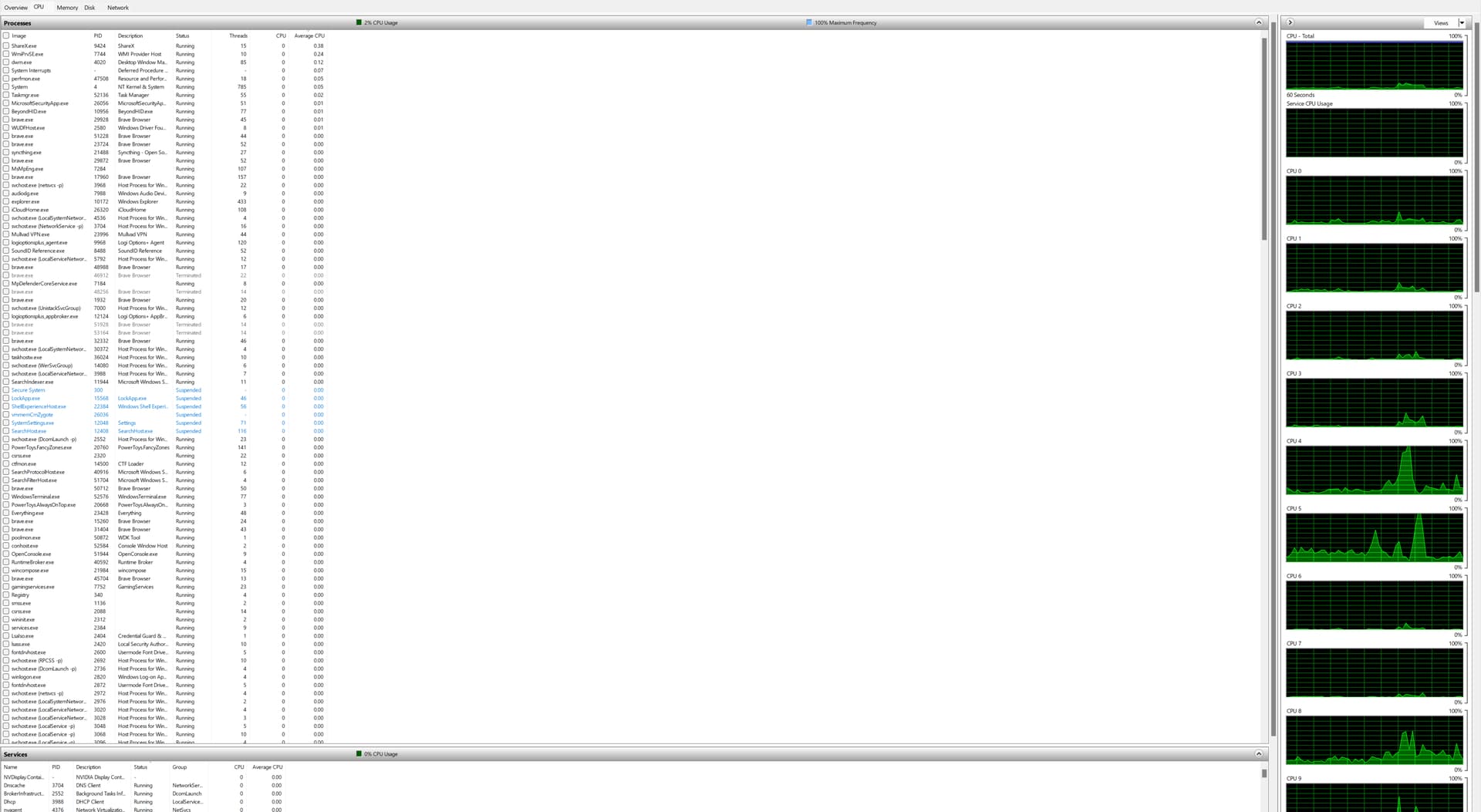

By the way, weā€™re back to WMI Provider Host using high CPU (5-10%+)

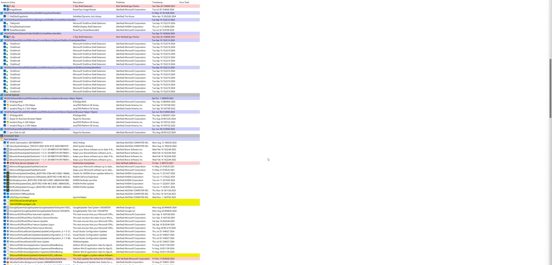

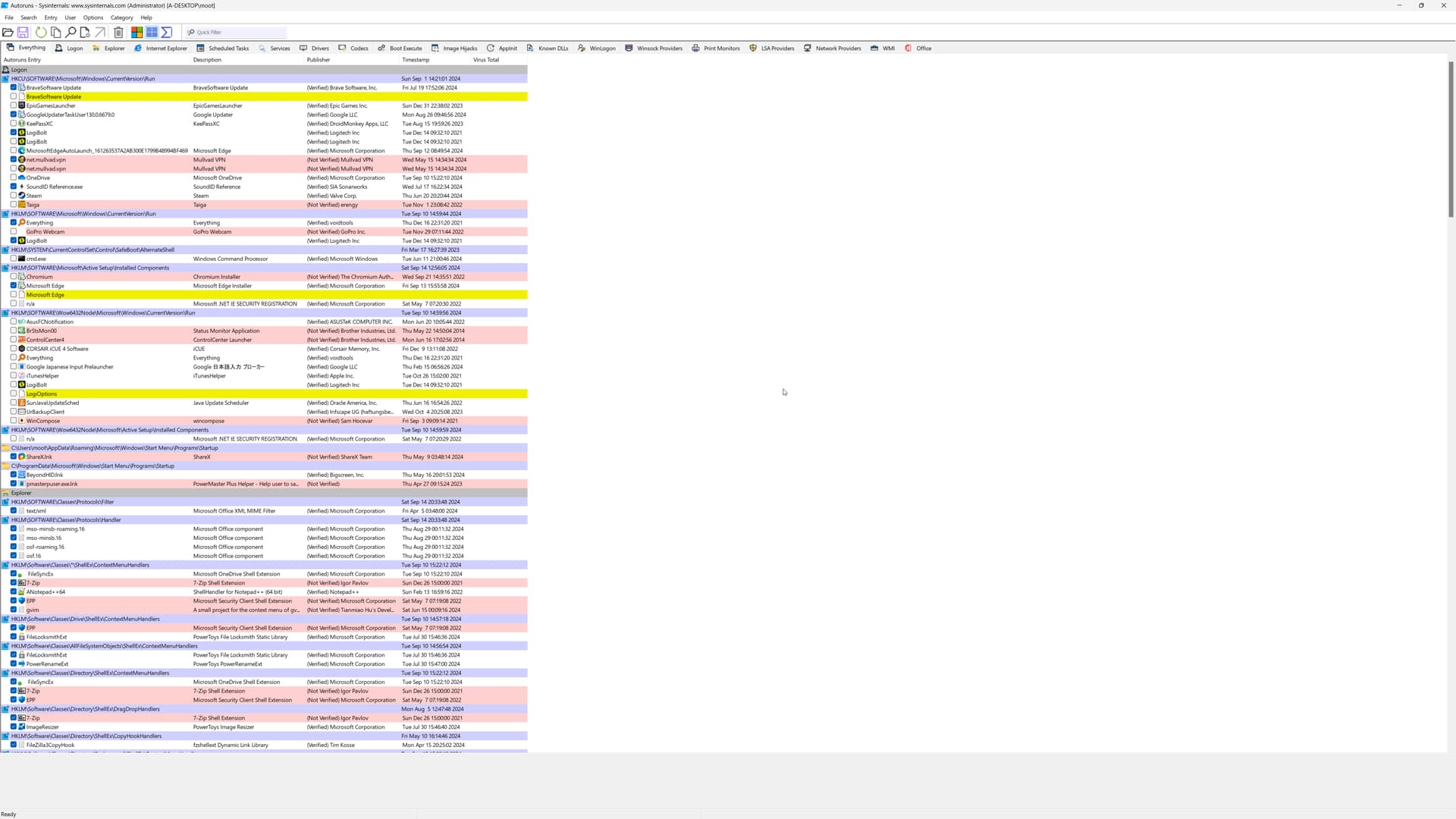

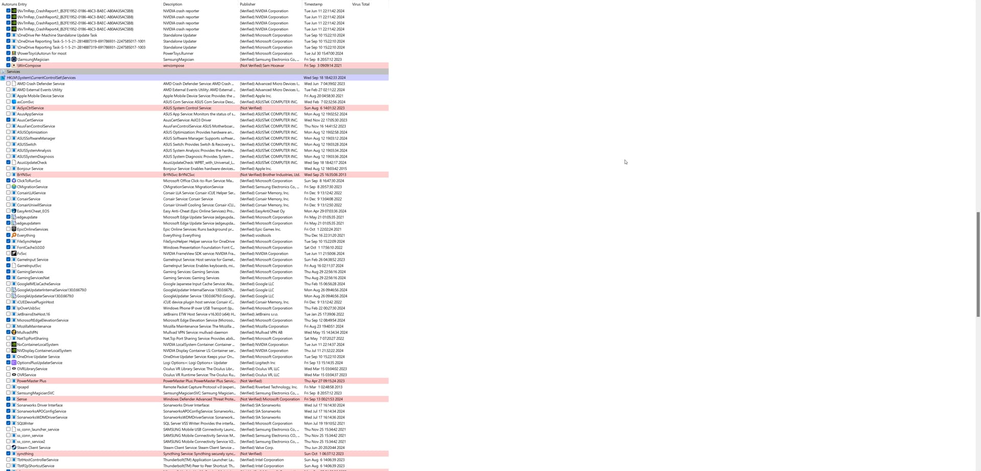

Check autoruns(download) with admin rights and see whatā€™s going on as well as resmon.exe to see what exactly is being used so much
Thanks but Iā€™ve already posted a resmon screenshot and it doesnā€™t provide much more insight. WMI Provider Host uses a lot of CPU and thatā€™s all I can see.
Not sure about autoruns, I have it and Iā€™ve used it but itā€™s not going to let me understand why WMI Provider Host is using so much CPU or why I am having a memory leak given the memory isnā€™t shown to be used by any visible process.
CPU usage by WMI Provider Host is usually a sign that another application is requesting data through WMI. That is why I suggested we look to see what it is requesting in resmon or autoruns to figure it out. Maybe there is something in the background that you may have missed.

Hereā€™s a resmon screenshot, sorted by CPU usage

Autoruns:
