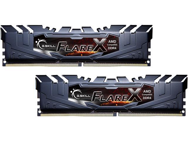

GSkill have the Flare X & Fortis series of DDR4 which is made specifically for Ryzen. I have the Flare X 2x8GB @ 3200 in my build, but have yet to power it up, so can't say how good or bad it is. But if you're looking for guaranteed compatibility at official speed, then it's probably a decent way to go.

Hey guys... the best SCHTICKS yet... so far for people trying to get past 3200.. theres alot of people making 3460 and 3600 on these. Only these ones though and specifically
