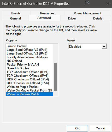

Try disabling wake on lan. The Intel driver is a mess and identified the wake up reason as bogus things.
In bios, or is there another way to do that in windows? I’ll try it but hopefully it’s not that, as I would like to be able to use that feature for minor convenience sake.
Make sure your Wake on Lan settings(in windows) require Wake on Magic Packet, and set up your wake events to use the Magic Packet setup. Otherwise, Windows post-7(and possibly later updates of 7) will aggressively wake every computer on the network that it can with general network traffic, unless those machines are specifically looking for the magic packet.
Both in Windows and in BIOS.
The Intel driver is stupid and even though I’ve set the Magic Packet only option it still woke up the PC randomly.
First confirm that disabling WOL solves your sleep issues. Then you can think about alternate ways to use WOL in the future. I did use a Realtek NIC instead. Works like it should now.
I guess I’ve got some googling to do later. I’ve seen the wake on lan settings in bios, not in windows (never had to look for it before) and “magic packet” sounds foreign (and silly) to me.
Go to the network options and find the button for driver/device settings. In the driver window you will find the options on the bottom of the list. Like Wake on LAN enabled/disabled and wake only on Magic Packet enabled/disabled. Just toggle those options.

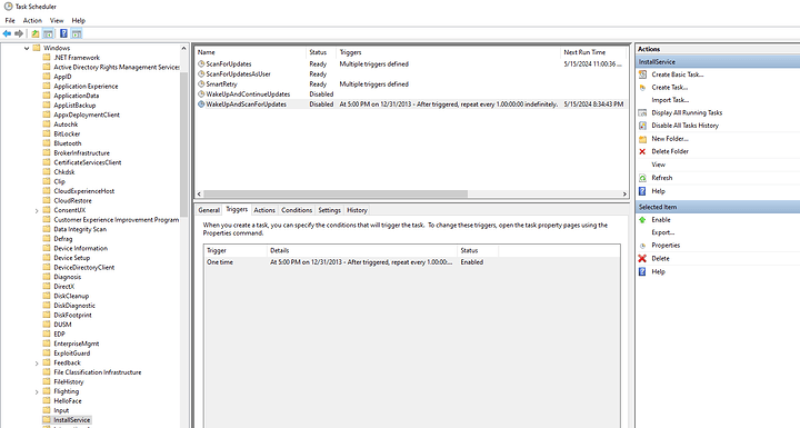

Another thing to check for is it could be an autowake trigger.
Check the Task Scheduler > Microsoft > Windows > InstallService
WakeUpAndContinueUpdates → Disabled
WakeUpAndScanForUpdates → Disabled
You can explore and edit the triggers and rules. As well as any active tasks.

For me, it was both of my Windows PCs w/ Intel NICs. Wake on Pattern Match just started constantly waking both of em after a Windows update like 6-9 months ago.
