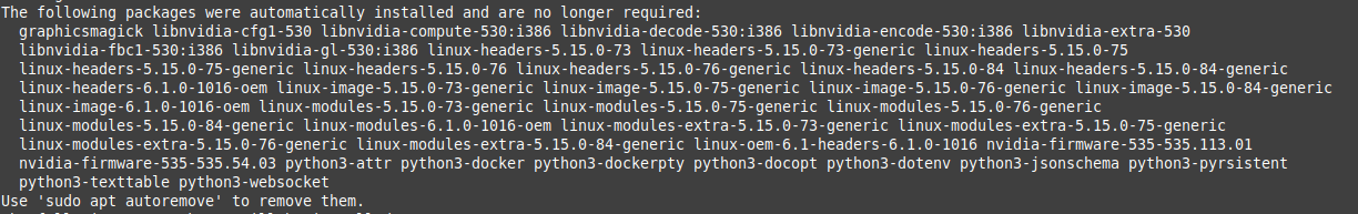

I just did an update and grabbed this screenshot. Over time these will build up. They may become deprecated and / or unsupported. eventually Not to mention a security risk if they have any vulns. Good to keep them at a minimum to reduce both disk usage and any exposure.
Oh yeah. I always run autoremove --purge after I see dangling packages like that. Warning that the purge flag wipes all your configs so you’ll be starting from scratch if you reinstall some packages
