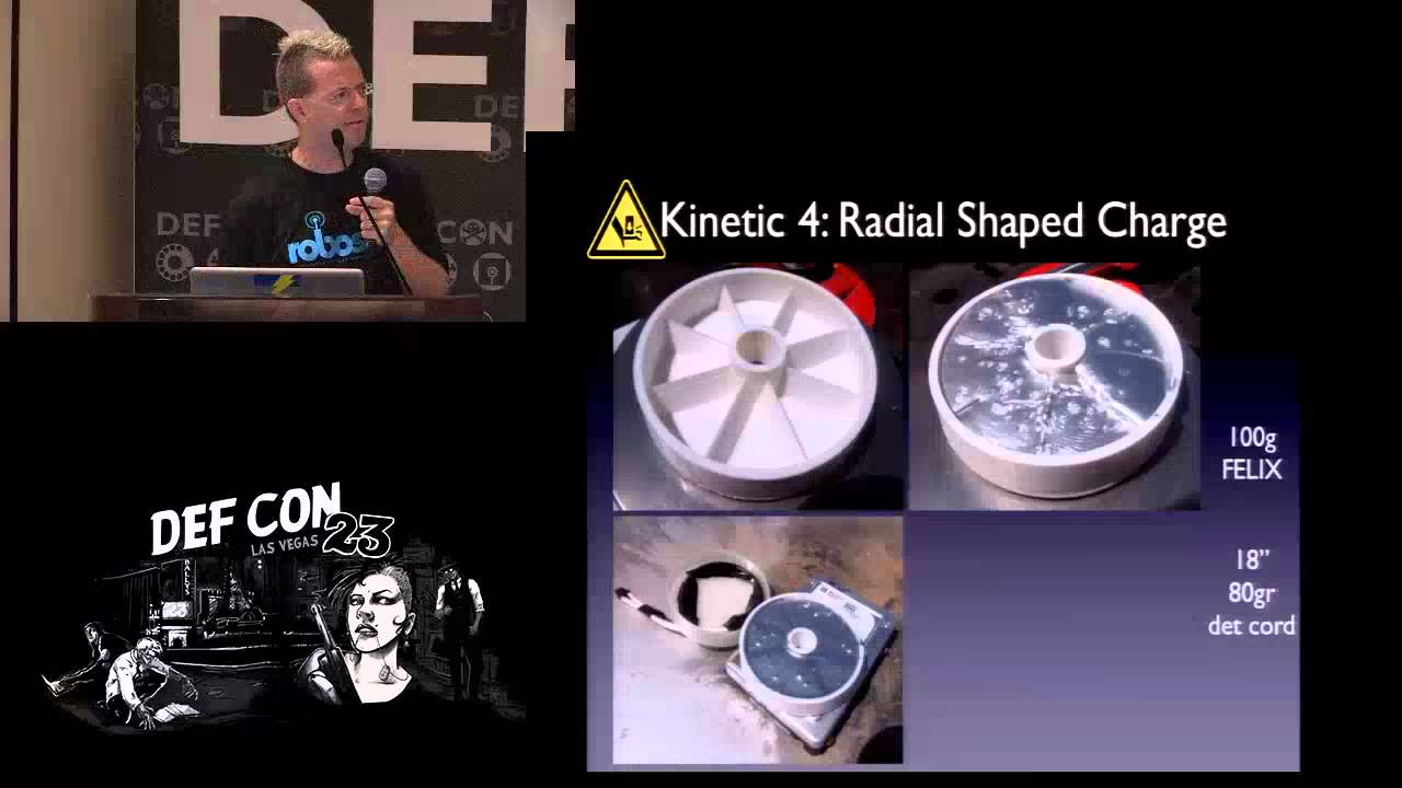

Thermite powder is completely inert and actually rather difficult to ignite
You need something very high temperature like magnesium or... peanut butter
Just enough of thermite powder in a small packet above each spinning hard drive platter should be enough to just reach and drip onto the actual Drive platter but not completely penetrate
Used in correct doses,
this should not really cause too much of a fire
as the only thing close enough would be the plastic of the power lines
Drop or two Of molten iron should completely destroy a hard drive
Whatchu talkin bout whillis?
Thermite is predictable and safe
Any video you have seen on the internet,
has most likely used pounds more than necessary to achieve the task
It does not have a minimum amount necessary to work
but it does have a minimum amount necessary to actually form a bead or a drip of molten iron
which is what we want to get out of the idea here
a drop or two of iron
to breach the outside case of a hard drive and hit the inner platter
