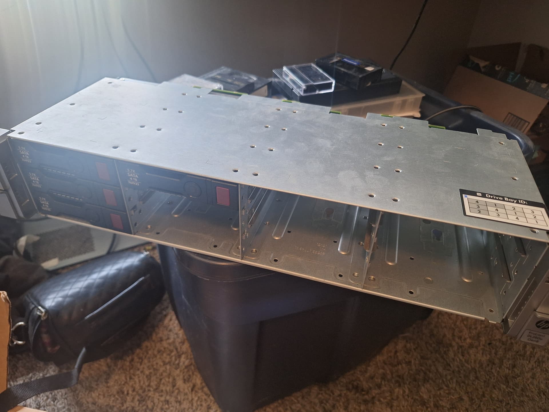

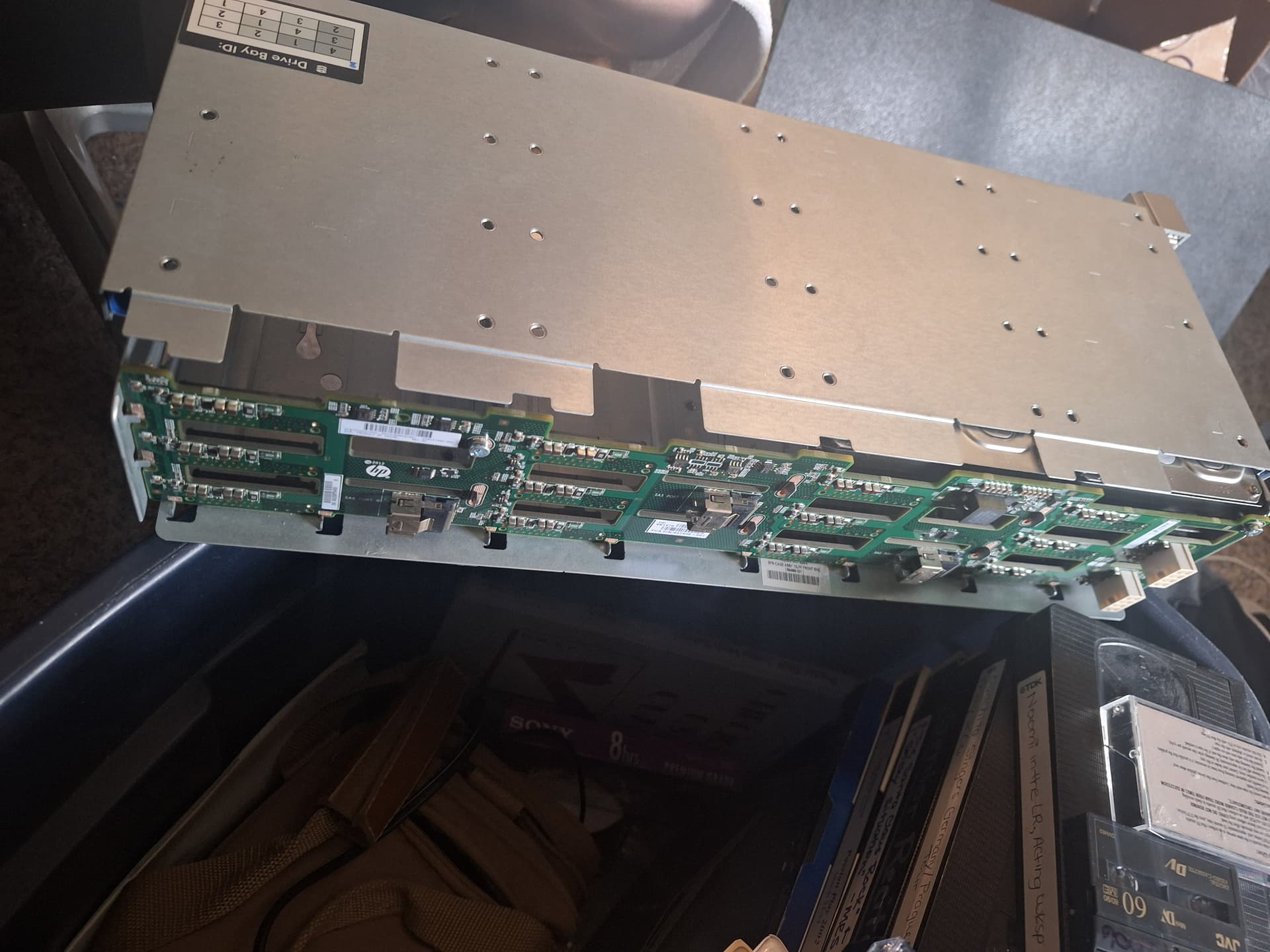

Ordered up 4 fans and some abs. I am trying to figure out where I want to put them. I am thinking of mounting them to the back. Probably an inch or so from the back of the of the backplane. Building a rectangular box, a fan for each section of 3 drives, and a divider so it isn’t pulling air through areas that don’t have a disc. I am also open to mounting fans to the front. Thinking of also taping over all the open holes in the side.
Orange is the back plane, black is ABS plastic, and pink is fans.
Changed directions 75% of the way through.
So far working pretty well. I’ll do another version and make it better.
